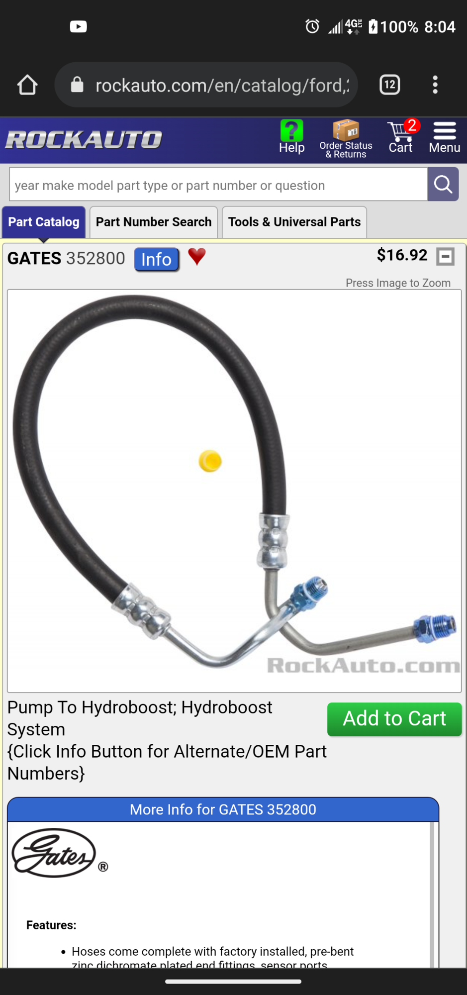

I like that! That's a Cool way to look at everything! And now that you mention it, there is also fluid in other areas that I could not really figure out. Like over on the main engine harness. That's a little ways away from the PS pump but, it was covered in atf. That sure is interesting. I might go ahead and order both a pump to reservoir seal and a new high pressure hose. RockAuto has a Gates brand hose for $16. I would like to put an oem on but, due to work being slow recently, I will have to do what I can do. Does it look like a good hose to you? Thanks for the help!

Well, I don't really have a napa very close to me but I also don't trust the regular auto parts stores like O'Reilly's and whatnot because I have gotten bad parts from some of them. I like using advanced Auto a lot but I always get brand name from them if I can. They have that brand of hose that you sent in the link on RockAuto for $15. They also have a Gates hose for 16. I have a lot of other Gates parts and have been happy so I might go with that one. Thank you for your help!
