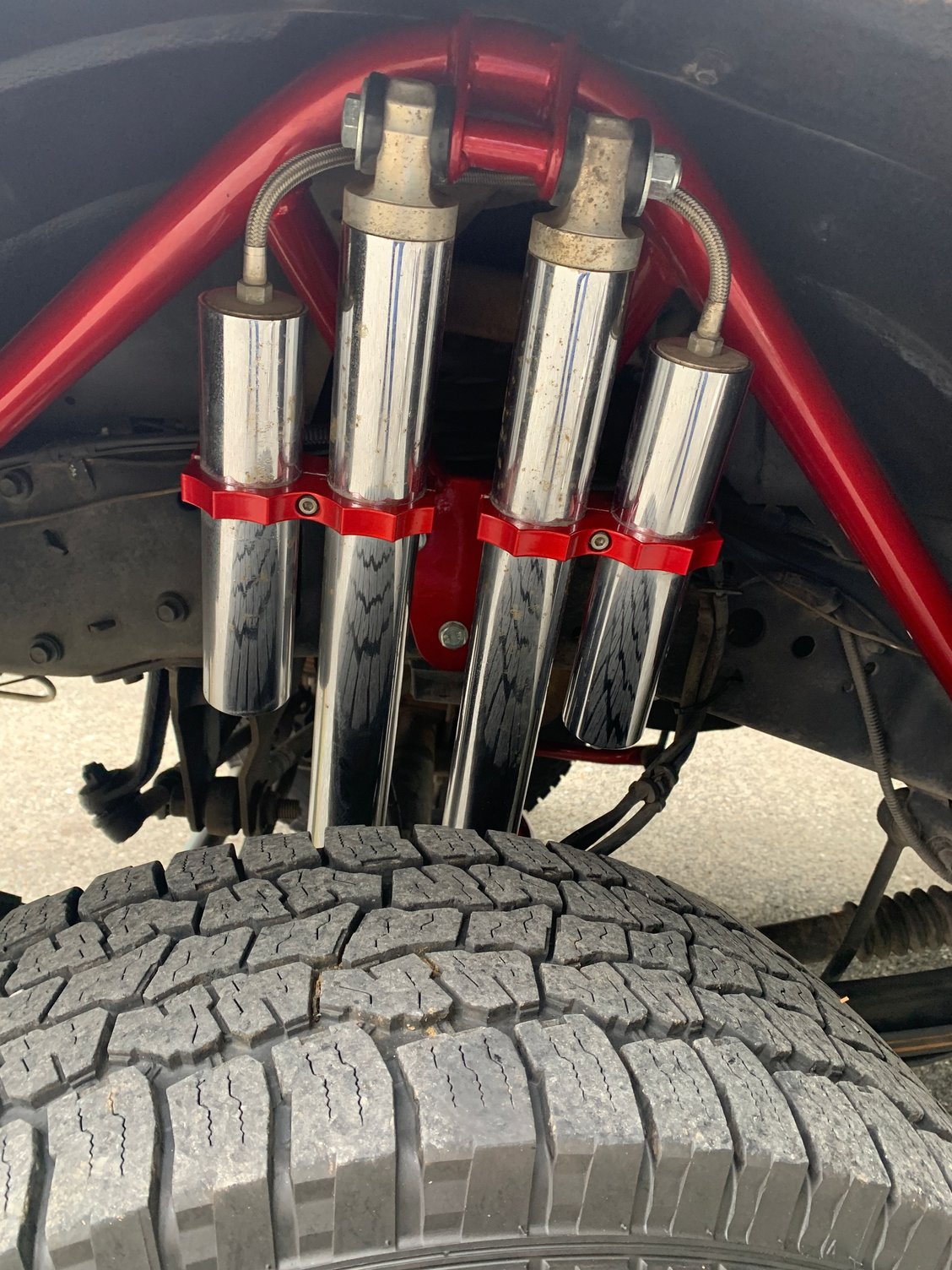

So I’ve just bought this truck f350 diesel and it’s lifted 8”.
the tires rub on suspension when wheels are turned not quit all the way. They look pretty stock the size of tires are
285. 75 R18. The previous owner said to get a 1 1/2” spacer for them and I checked napa nope only got 5/16”.
if this is correct where do I find one or am I better of getting different rims
for these tires-there like new. I’m not planning anything heave just my 4700lb boat for now. I really don’t like the looks of these rims but I’m not really doing any serious off roading either. How do I figure out what size after market wheel to go with these tires or do I just start over? Any help is appreciated a lot! I wouldn’t mind if they stuck out more maybe just get spacers?
here’s a pic. Thanks jon

You definitely don’t need 8” of lift for those height tires, a level would be plenty. Not sure how or why you bothered with Napa to determine wheel spacer, just pull a wheel and measure. It should have a 2” to run those wheels on the older axle in the normal position. And most importantly replace every single lug nut like now. Those wheels are hub centric and use a nut with the washer built in, the lug nuts being used are for aftermarket wheels that are lug centric. Pretty much asking for trouble.

The problem is that the wheels are completely wrong for your truck. The original wheel/tire combo was 265/75r16 on a 16x7 +6.35mm offset. The new wheels are 285/75r18 on a 18x8 +40mm offset. In about 2005, Ford changed the Super Duties to have the higher offset wheels (they sat more center to the truck). Ford also changed the entire front suspension of the trucks from leaf to coil springs and the hubs sat slightly further out allowing for the larger backspaced wheels. In the end it really wasn't noticeable until someone put a high offset wheel on a truck intended for basically a 0 offset wheel. They tucked a lot!

If you like the wheels, just get some 2" spacers. Make sure they're billet and use actual wheel studs. Otherwise find rims new you like in the size clarkbre suggested. That truck really needs a 36-38" tire to look right, there's wayyyyy to much fender gap.
It's hard to tell from the pics, but i think i see all kinds of hack. On top of the incorrect rims and lug nuts, your brake lines look really tight, like they didn't install extended length lines to compensate for the lift. I'd at least cut the zip tie holding it tight to the frame to give it a little more play for now. I think I see the factory rear block bump stop tab halfway between the axle and the frame..does that thing have stacked rear blocks? That's sketchy with that much lift, it should be a single block, preferably with a traction bar. And those dual front shocks are complete overkill, those front leaves don't have the travel to require those shocks, I bet you're way overdampend, and it has a jarring ride. Are they even a name brand shock? If you took one of those off , it'd probably ride better. It looks like they put a drop track bar bracket on..but at that lift height it should be reinforce better, I bet that thing flexes under acceleration and braking.
