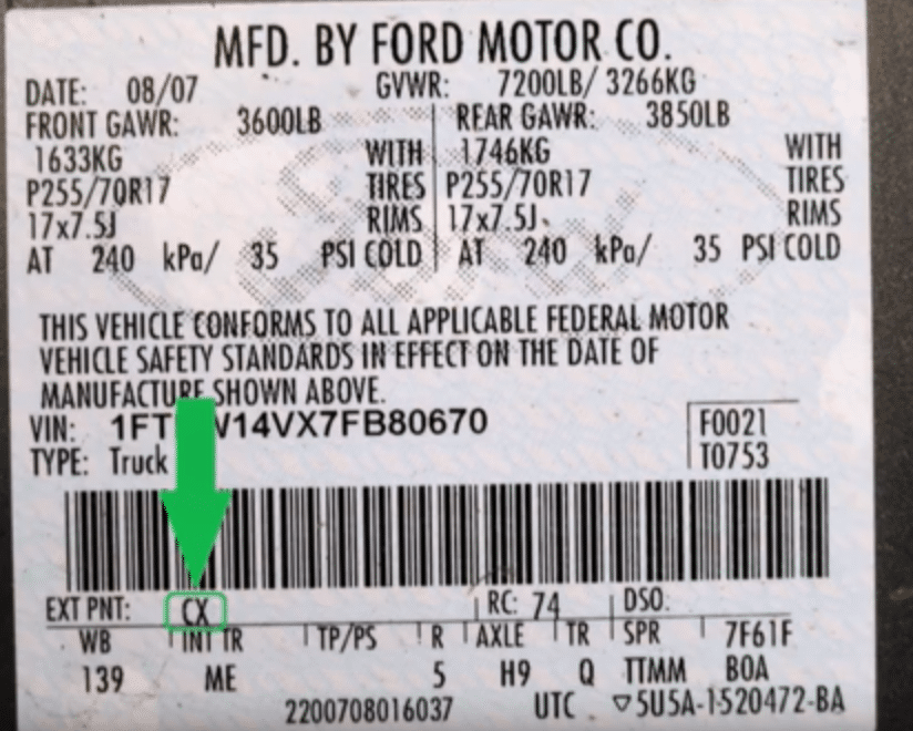

Drivers side door jam (B pillar) should have a white sticker (Safety Certification sticker) and the paint code should be on it.
The exterior paint code will be labeled as EXT PNT followed by two characters. Or at least this should get you in the ball park.
https://hdpaintcode.com/1990-to-1994...y-paint-codes/
