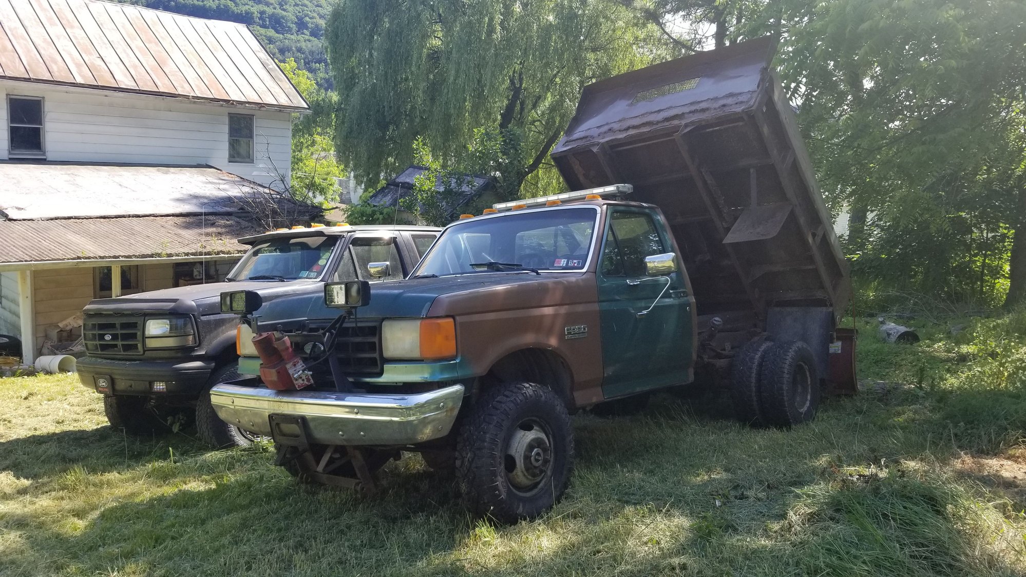

I have an 88 F-350 4x4 dually dump truck that I want to lift approx. 4" or so. I want to run 36x16.5x16 single mud tires so I stop getting stuck in my yard (sinking). I don't haul a lot of weight. I want it to look like a overgrown Tonka truck.
Question:
Does anyone know of a lift for it? Problem is the 2.5" wide rear springs and 3" wide front springs.
Can I put 3" spring hangars and springs from a F-350 pickup?
I want to be able to switch from dually wheels to my singles by switching front rotors.
I have a 96 F-350 donor truck with a bad frame.
Thanks for the help.

Is the dump ruck a cab n chassis truck? If so, they have a different frame width and rear axle. Which would make the axle swap not feasible.
The rear can be lifted using blocks too. You could call ATS springs for instance and ask then what springs might work for your setup and give you whatever lift, front and rear.

It depends on whether his truck has a pickup frame or a CnC frame. If a pickup frame then a axle swap is straight forward. If it's a CnC it's more complicated.

He mentioned 2.5" wide rear springs -> it's a c&c truck.
Lots of older GM trucks used that spring width, might be able to find something off one of those in a U-Pull-It yard for cheap, if not new stiff should be readily available.

Yes, it is a cab and chassis truck.
It has 2.5" rear springs and 3" front springs.

What tire pressure are you running? Does this truck run down the highway or more of a property truck? Sometimes airing way down fixes sinking, but its very inconvenient if you're then needing to hit pavement at speed (because you'll need to air back up). Just something to consider is all. My pickup with a truck camper seeks bedrock at 40+ psi. Drop to 18 psi, just floats, but it's only ~6200#, not 8000#+ like I'd guess your truck is.

+1 for airing down. Unless those 36" tires you're looking at are stupid wide I imagine you've got a better contact patch with the duals, unless it's the front end that's sinking.

I have 36x15.5x16 Mickey Thompson Baja MTZ's, thats why I said I'd like to swap them on.

I've no idea what sort of weight you're loading that thing up with, but the other thing to consider is, I can guarantee those MTZ's aren't Load Rated particularly high. That's not what they're built for.
You might be fine, you might not, I have no idea. I just generally try to avoid exceeding specification as much as possible.

It's a Cab Chassis. No Factory 4wd Dually Pickups were made before 99.
