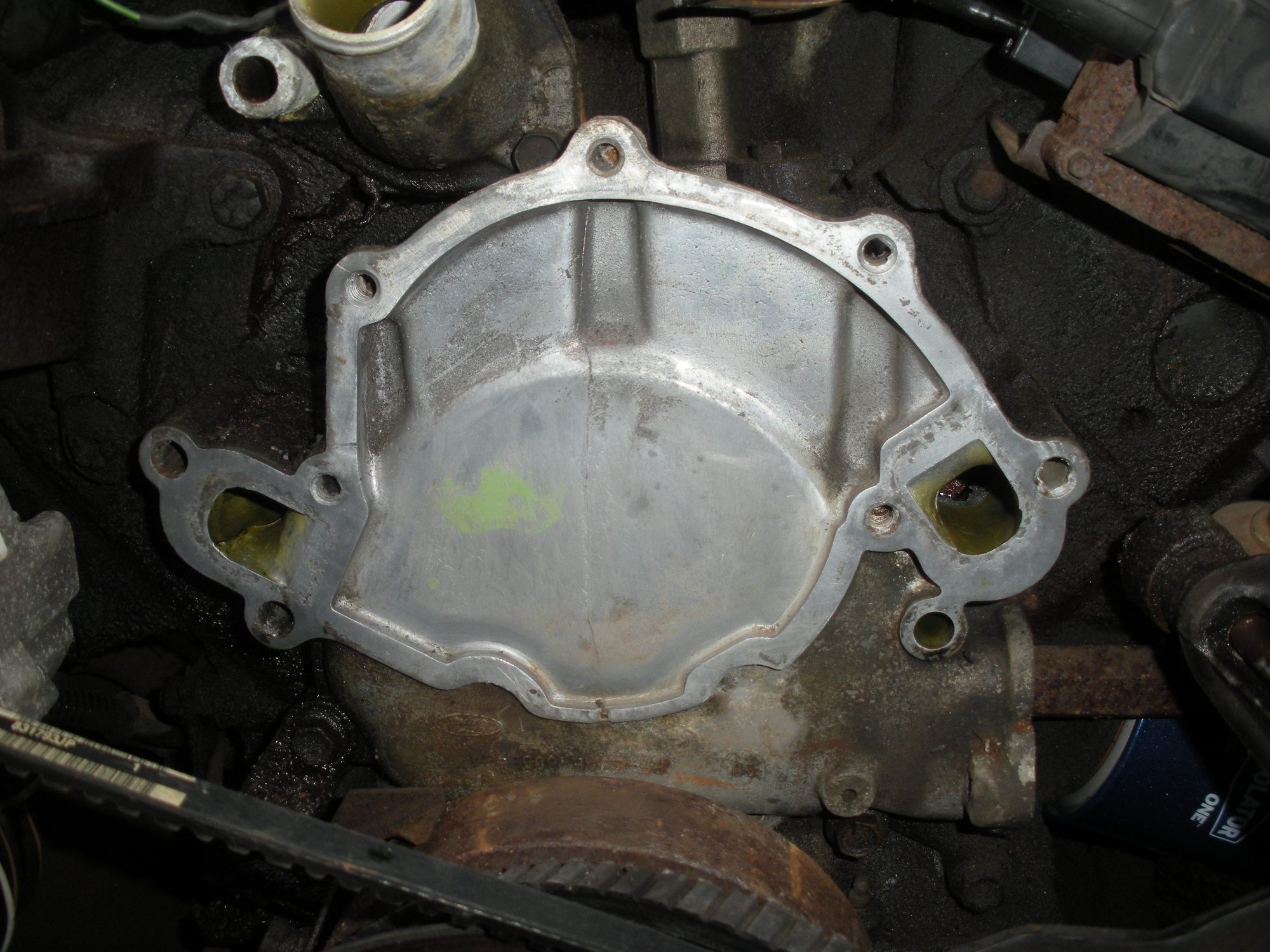

Here's my before new water pump install. As well as the gasket sealer I used. That was recommended by someone on here. Zero, leaks. I believe I only used it around the water jackets.

I'm getting confused by "backing plate" are you talking about that plate on the backside of the water pump ?
Or the timing chain cover and water pump ?
As far as I know, that plate on the back of the water pump was/is sealed at the factory. You should not be messing with it.

The backing plate that come on the water pump. It’s a mustang water pump as stated in original post. They come with a backing plate that has a gasket between it and the pump. Then they have 2 small bolts that hold it on to the pump. That is the gasket that keeps blowing out. I will try and attach a picture. You can see the 2 black bolts at the bottom. It blows right beside them.

Sorry, but thanks for the picture. I'm new to these newer style water pumps. The OEM style I got from NAPA a few months back was for my 86 5.0EFI, which also has the backing plate, which is sealed from the factory.
I guess you have verified the sealing surface is flat with a straight edge ?
I would think if it's a paper style flat gasket that sealer I post a picture of would work fine.
Have you looked through the "related threads" below, I see someone there used Honda Bond.
