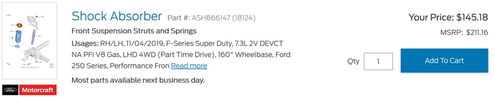

I didn't see any votes for the Tremor Front Shock Absorbers ASH866147. They have a hydraulic bump stop built in for bottom 2" of travel and the springs from the Tremor level the front 0.75". It is like position sensitive damping. Really improves ride going thru dips and over speed bumps eliminating bottoming out on 2020+ Super Dutys.
Tremor Shock
Ford Parts Tremor Shock

I agree with you about Tremor shocks. I own a '22 Tremor and because a lot of Tremor guys were immediately removing their Tremor shocks to install boutique shocks I thought since I had some almost new Bilstiens off of my 2018 Superduty I'd see if the boutiques were actually better.....they are not. I reinstalled my Tremor shocks as they do ride better and feel more in control.
There should be a lot of almost new Tremor shocks for sale!
