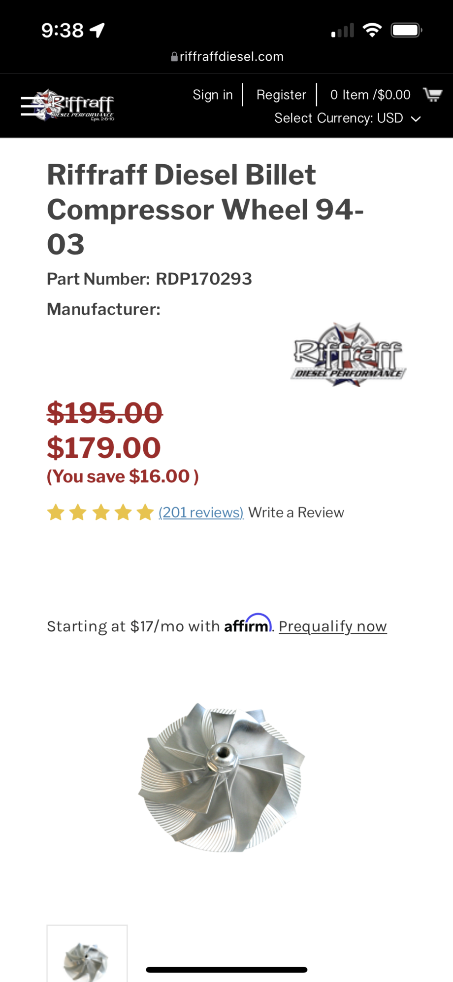

as for reliability mods I would add Intercooler to the list, rebuild turbo with the severe duty 360° kit and billet wheel, larger trans cooler if auto, valve springs.

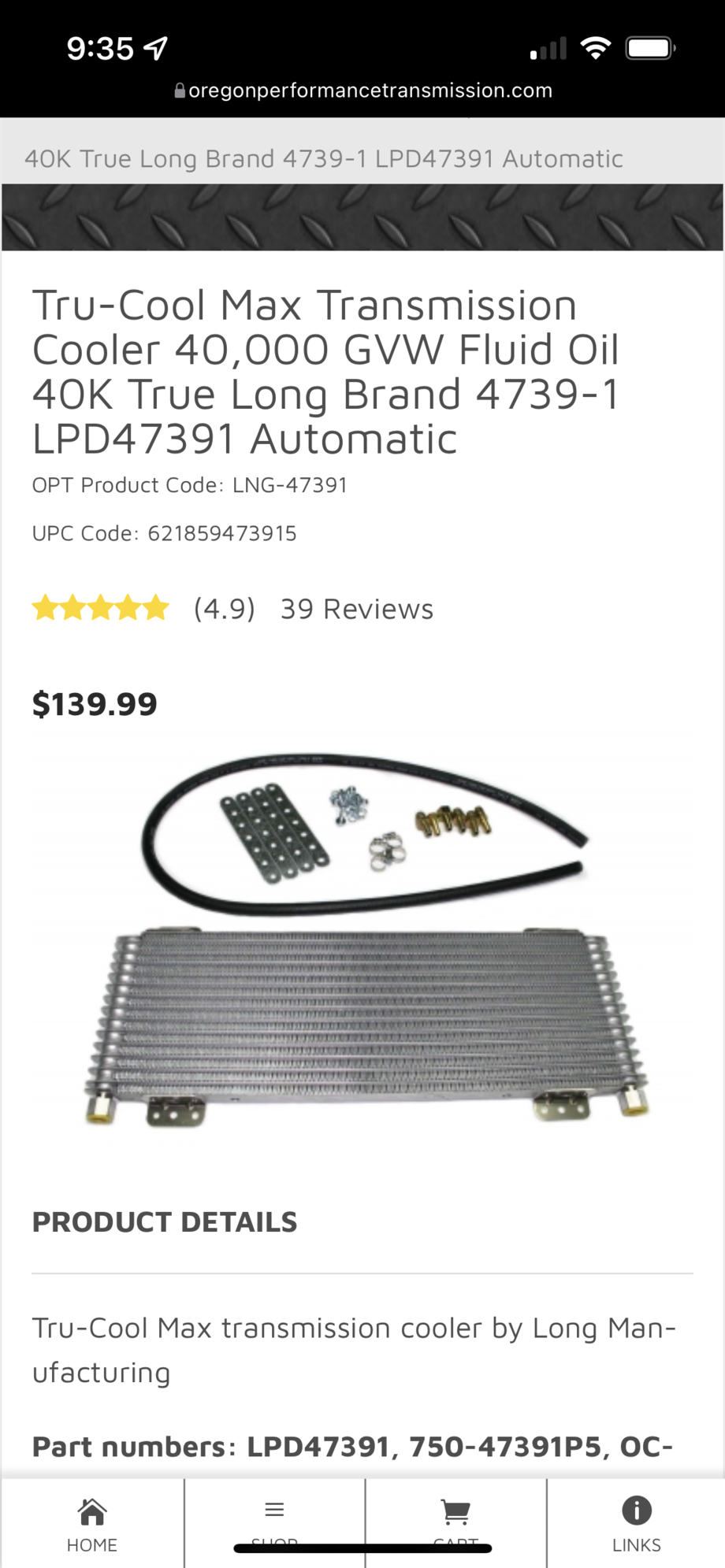

Trucool 40k gvw trans kooler!

Coolant filter and e fuel. Up pipes and wicked wheel rebuild for the turbo. Get a coolant flush with fleetcharge sca coolant

Thoughts on these items? What brand would people recommend for up pipes? There is a lot out there.

Agreed on that KC balanced assembly, that S300 wheel looks badass. @Jarrett Campbell has that wheel and finally an HPOP to keep up, seems like a great combo. That wheel was not available when I rebuilt my TP38. I do like my 1.0 AR turbine housing and recommend it.
