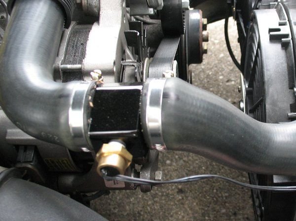

Now that I'm going will nilly rewiring every bad thing in the truck this week, I may as well tackle the electric fan. Previous owner connected it, it works, but it's a little janky. There's currently no circuit breaker installed, and I don't love the location of the relay, so I figure I'll re-do it since it's a balmy 15 degrees outside.
I don't have any open sensor ports on my intake, so I'm considering using the Mishimoto Coolant Pipe Adaptor. Would love to hear any experiences you may have had before I do it. I'm a little hesitant to cut a radiator hose in half if these things suck.
Here's what I'm talking about.
Picture for description. Not my vehicle.

I'm not a fan of splitting coolant hoses for temp sensors, or flush ports. It just introduces two new potential leak points. What about swapping out the thermostat housing for one that has a port in it?

I've been using the rad. hose sensor for more than 10 years w/o issue. I like the BMW two speed sensors b/c you can purchase the 90* elec cap, and that looks way better than most caps I've seen. Beck/Arnley also makes two speed sensors. You can ck some of the 'Taurus fan swap' vids on youtube for the temp ratings of diff sensors. I like to have the ground activated system so if the sensor fails I pull the low speed lead and shove it on the ground terminal and drive home with the fan on low. Better than walking.
