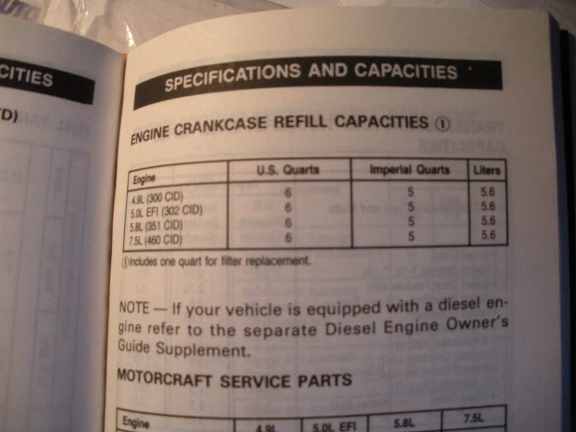

Your Owner Manual says 10W-30 or 10W-40. Adds that 5W-30 is okay for cold climate.

Yes, 10w-30 is what you should be using down there. Also 6 quarts.
