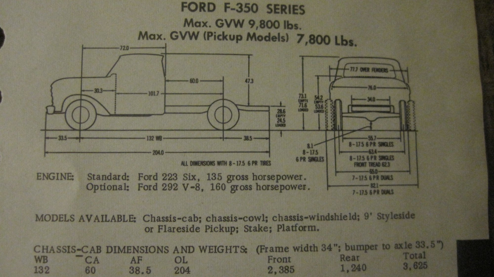

I've searched but found nothing convincing. I'll be picking up a 63 F350 tomorrow with the dual rears, and I'm nervous about it fitting on a trailer. I assume it will fit if I take the outer rear wheels off, but does anyone happen to know what the outer wheel to outer wheel width measurement is on one of these? If I roughly guess based on my 65 F100, it would put me at around 84"... Any help would be greatly appreciated!

With 17.5's around 82", with 16" your probably right on with 84". 7.50-16 are wider than 7-17.5.
the dimensions.

Thank you! I tried finding a scan of that online but never came across that one, mostly just F100 versions. Thanks for your help! I think I will just plan on removing the outer wheels to make it fit with no issues.
