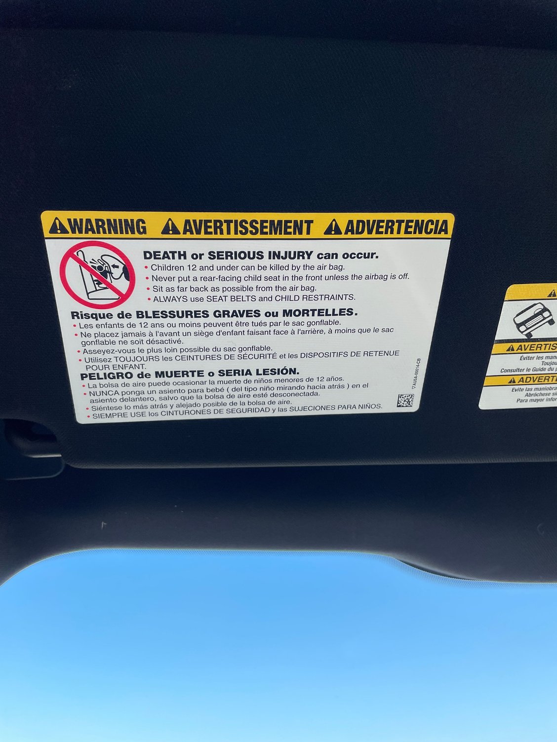

I’m sitting outside of TJ Maxx like a properly domesticated dad, and staring at the stickers on my visors of my new truck. Can these stickers been cleanly removed?

I don't think so. The fabric that cover that area is cheapo stuff.
I was going to go to a Fabric store, Michaels or Joanne, and get either Felt fabric that color and glue it over it - less noticeable. Or those Knee patches but I couldn't get a good color match on my car that I just got rid of.
I've not done it yet to the truck because I am deciding on selling it or not.

I tried one of mine, you can still see the mark as the glue gets down in the fabric. My vette is suede so they came off clean. Going to just try and ignore them.

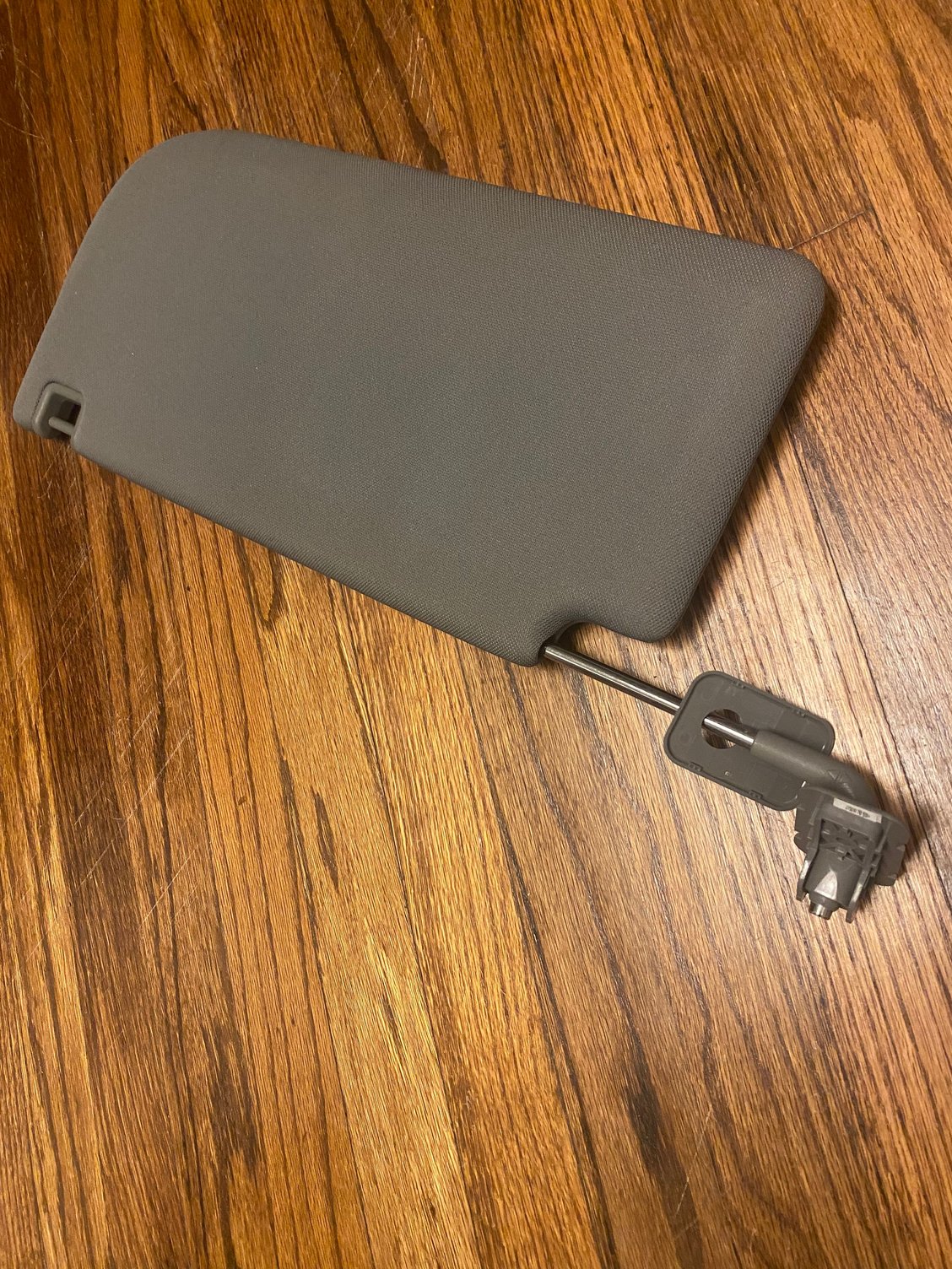

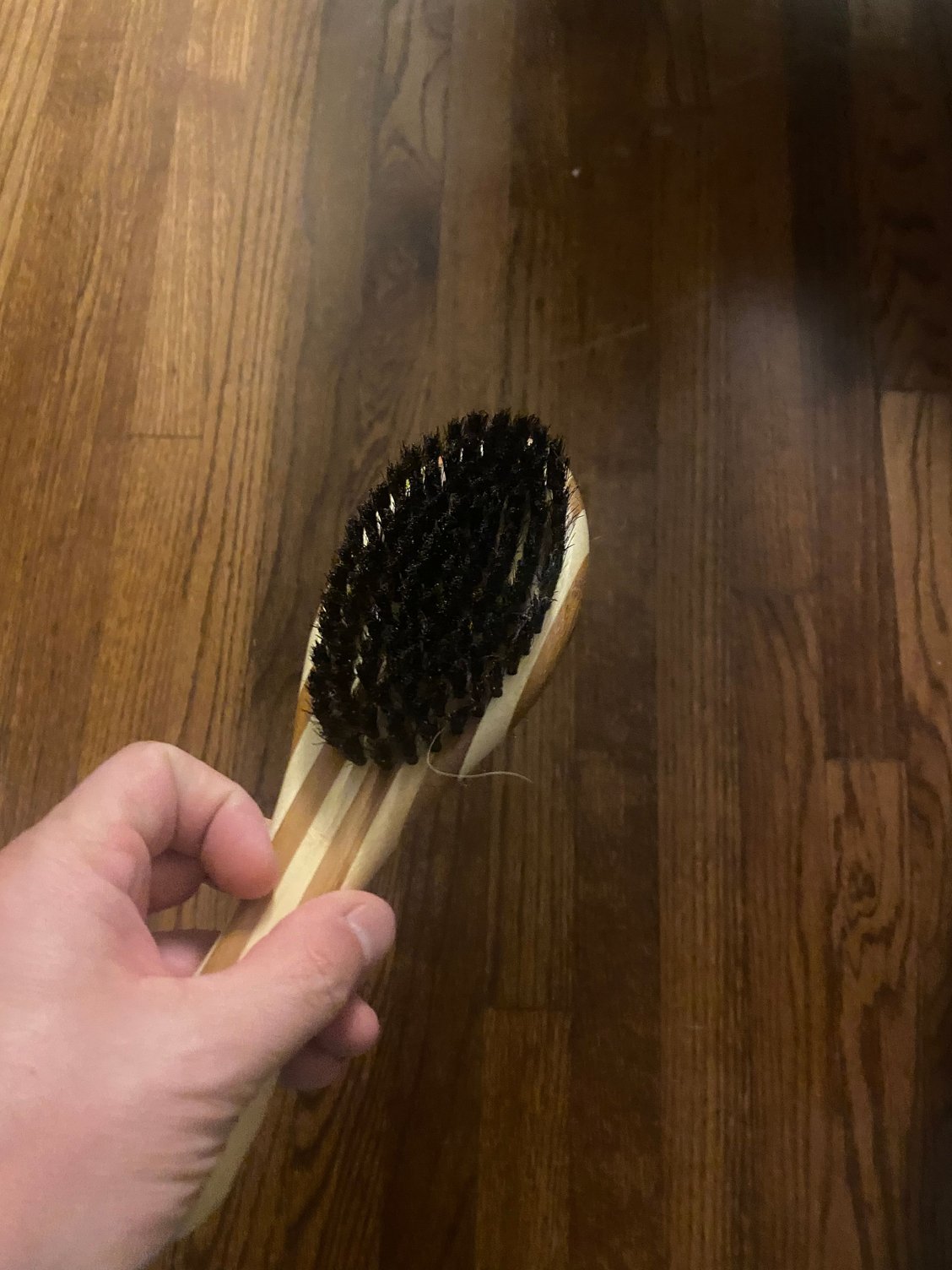

Hair dryer hot without killing the fabric. Peel off sticker.
Wet it some with rubbing alcohol.Get a mild stiffness dog/pet brush (nylon) and scrub it while applying gentile heat.
Takes a few tries. I have pics of my visors and brush if needed.

Really?
Got a pic of what it looks like afterwards?
I couldn't even get the dirt off my head liner in my car because I was afraid it would just rub off the fluff they stick on

Dog brush and visor.

I'm a little worried about selling a vehicle with the stickers removed, I'm thinking I'll get some visors from the junkyard and do as the guy above did with carefully removing the stickers. Then I can swap the originals back on if/when it comes time to sell. Plus if I mess it up I only damaged some junkyard takeoffs.
