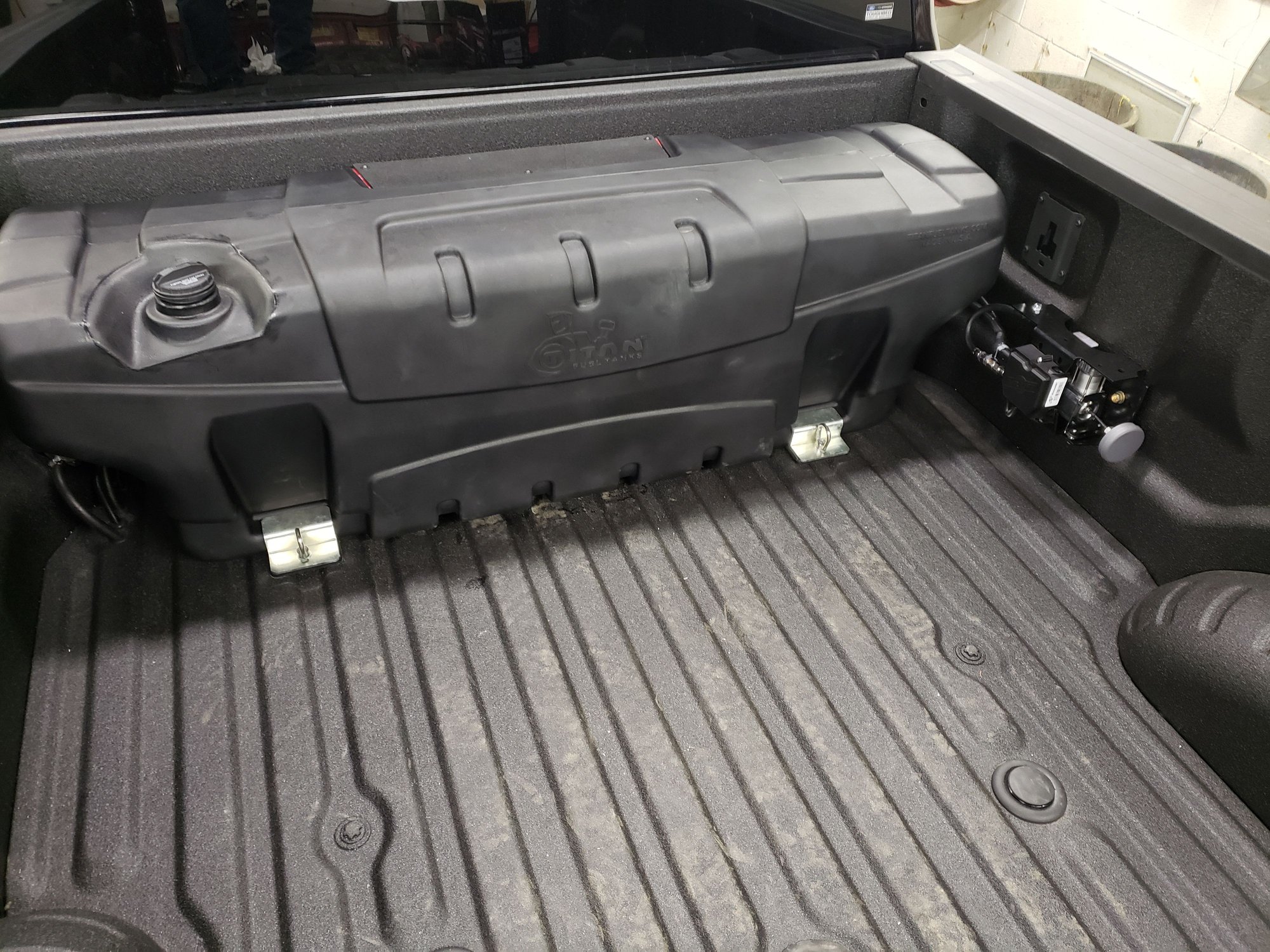

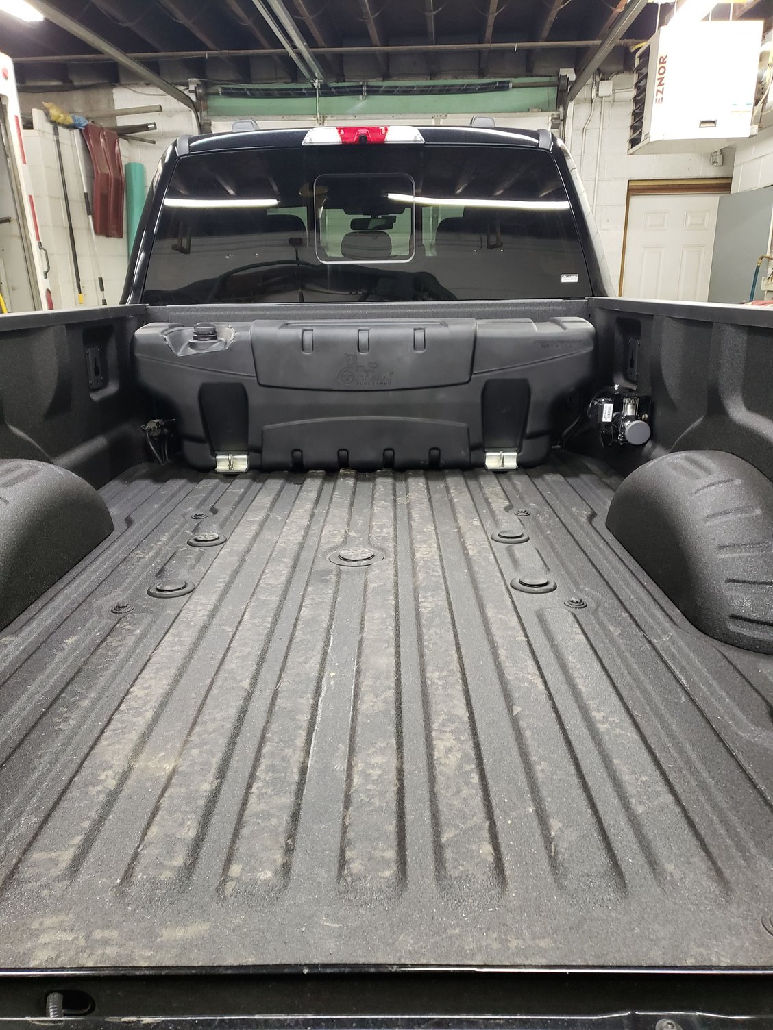

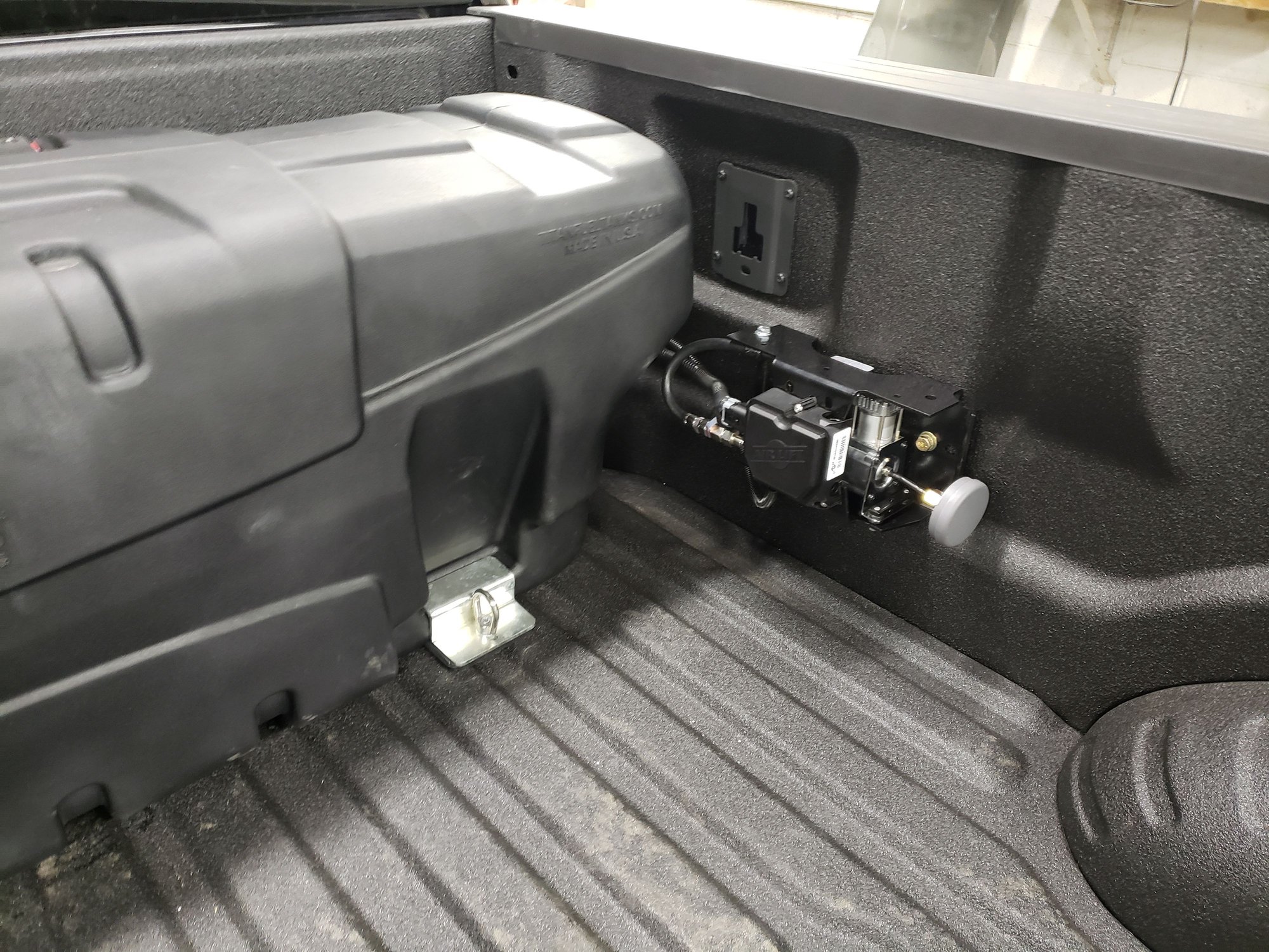

it’s not a Viair but this is how I have my Airlift WirelessONE setup in my 2020 and how I’ll be setting it up in my 2022 when it gets here. I has an Extang Solidfold tonneau so they’re covered from the New York weather and road salt and when I’m towing my 5th wheel with the cover folded up my transfer tank and compressor are still somewhat covered under the forward most panel.
