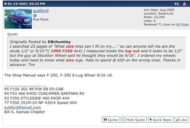

I have a 1995 2wd f350 dually, I can’t find the right lug nut dimensions for the front wheels. I have aftermarket rims and have already tried m14 1.5’s as well as m14 2.0’s. Anyone know what size I need?

Those don’t work because they aren’t metric thread. You need standard lug nuts.

Any idea what specs tho? Like as far as thread pitch and such, the current nuts have a 7/8ths head

Yes. Reread my answer.

My bad man, just saw the image, thanks for the info
