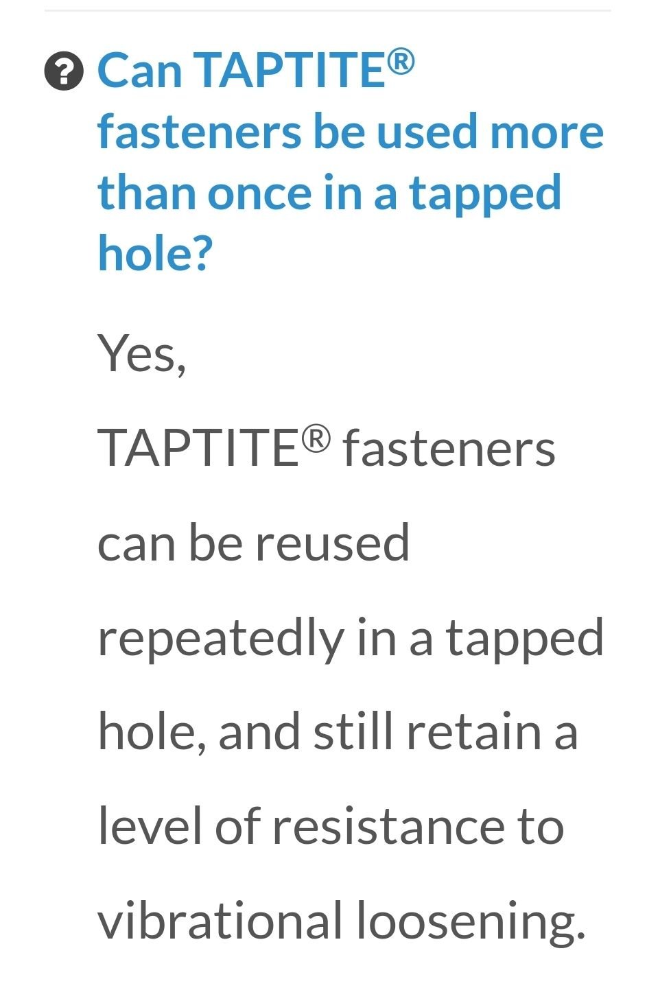

Originally Posted by bobv60
I still believe it is the self locking feature built into the bolts that makes the OEM recomend not to reuse them
If by self locking you mean tri lobular bolts, well yes, it appears that is what they use. But my very limited understanding of this type of bolt does not include self locking (it appears they do have variations that tout self locking ability). From what I can tell, thread forming is their main feature. There is some thread cutting, and some thread deformation happening, I'm not clear on the specifics of that or how affected the threads are that are in contact when fully tightened.
Here is some brief info about the type of bed bolts used by Ford. It might not be exactly specific in wording to the Super Duty, but I do believe it applies. Also, I'm sure additional, more detailed info can be found elsewhere.
https://taptite.com/applications/ford-f150-box-bolt
.....and
