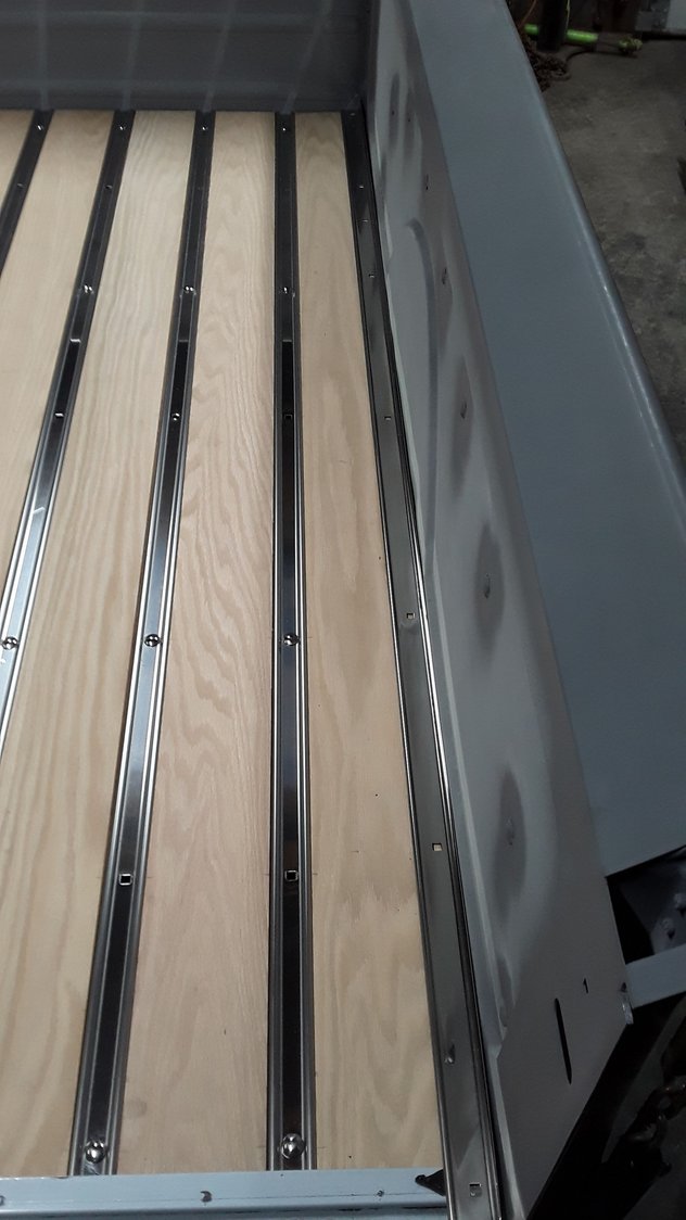

Here is a pic of my 54 F100 bed with the painted angle strips used to cover rusted out areas and to provide more strength and stability to the bed sides.

Abe and bls49, Thanks for the pictures. I am going to look again and see if I can drill some holes through the bed frame and mount them down like in your picture Abe

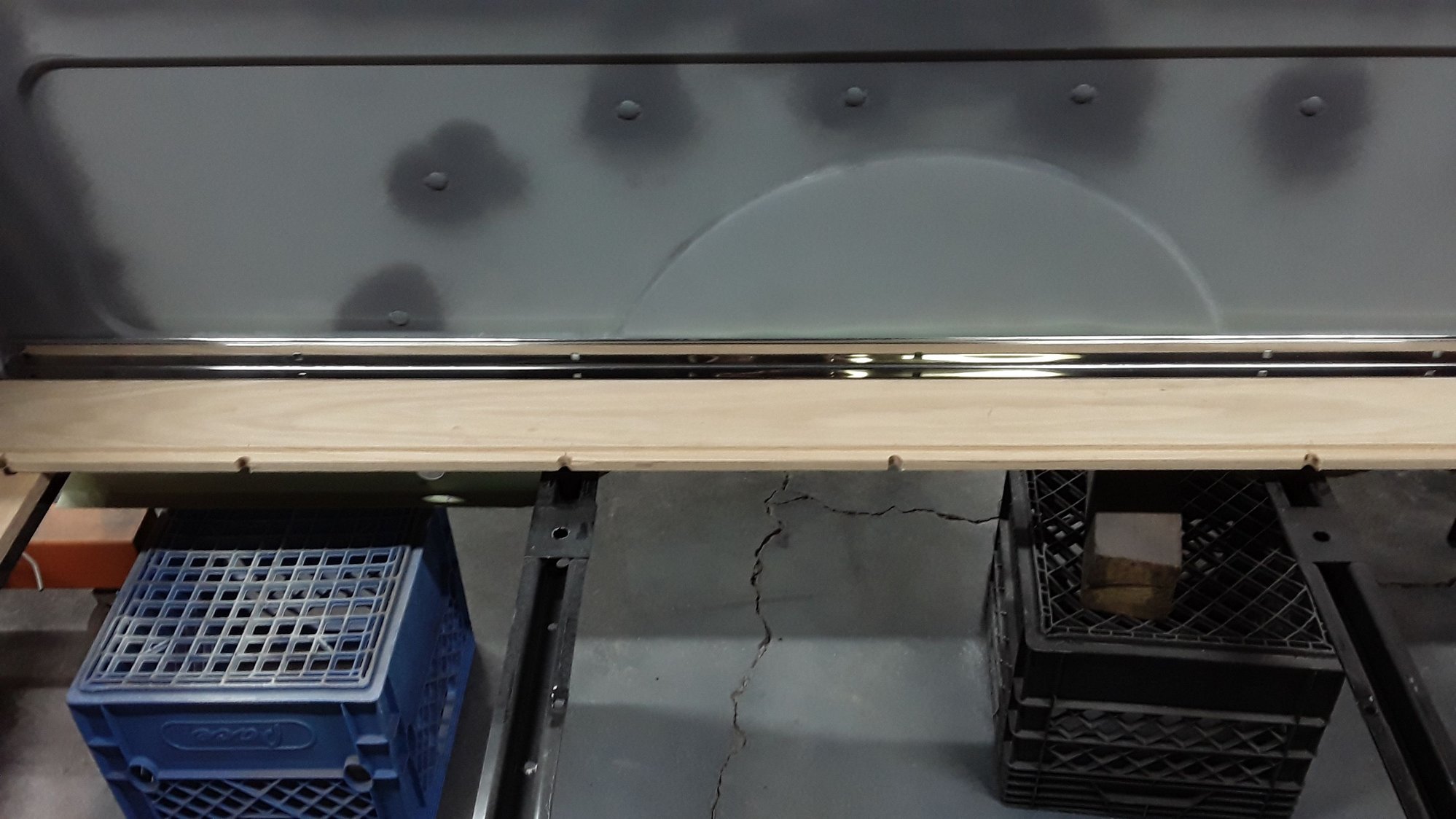

1949f1's Avatar
1949f1
Joined: Oct 2004
Posts: 1,719
Likes: 506
From: clinton,tn
I put the bed wood that I have worked on and pre fitted too many times to count back in the bed yesterday. The bed angle bed strips are just sitting there but the rest of it is bolted down. There is no way to use carriage bolts in the pre punched holes do to the way the 49 bed frame is made and if I turned the holes to the side the two edge holes will line up with the stake pockets on each end of the bed. I may just use polished stainless wood screws with stainless washers to hold the strip down to the wood. Not sure yet. The strips are not made for a 49 and since they are polished stainless welding them in is not going to happen. I also need to cut them a little shorter.
