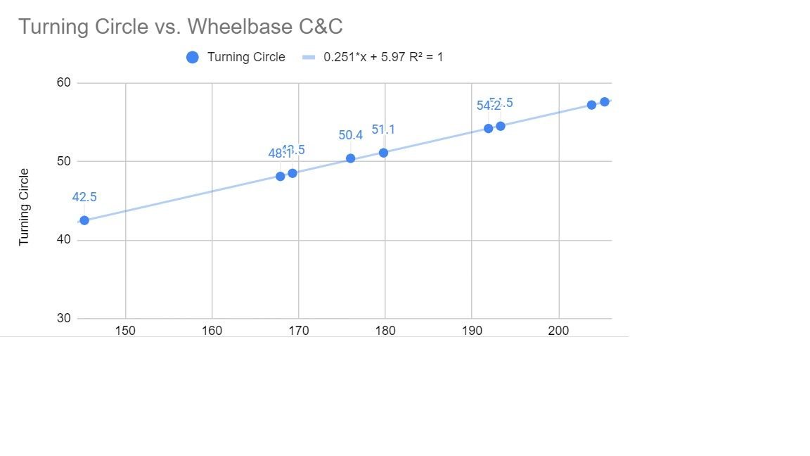

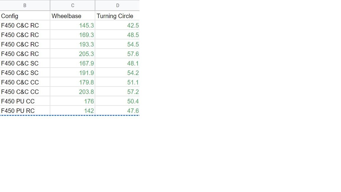

I was looking at 'what if' I swapped F450 axles under a 2017 350 vs a 450 pickup regular cab. I looked around quite a bit before finding the info. Posting in case someone else is curious.
Interesting the F450 PU CC aligns to the C&C data, but the PU regular cab has a higher radius for the given wheelbase. Its like they increased the radius on the F450 pickup with the regular cab. Not sure why the F450 RC has the same turning circle as the F350
Turning Circle as function of wheelbase below for F450.

Google Sheets does the siferin...
From what I read the turn in on the 450 axle is 45 instead of 35* on the 350. The wider axle and knuckle geometry allows for the wheels to turn further. I had read the F450 frame on the pickup and C&C was boxed till the end of the cab, but the C&C is channel cab to tail for easier upfitting (also more flex). I think the track widths are the same between C&C and PU models... so thinking the frame construction isnt a factor in radius.

I read somewhere on this forum? it was 35* turn in on the 250/350. I have no idea the actual. The data says its ~13% difference and nearly 6' for the wheelbase I'm looking at.
