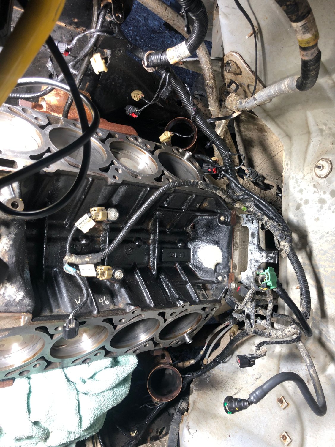

Pics

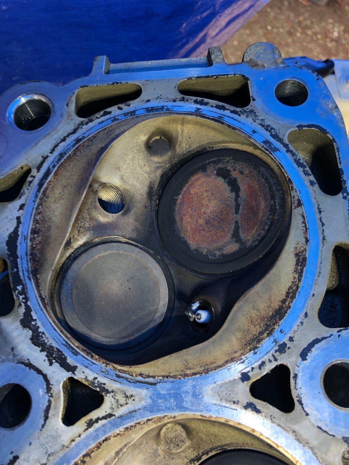

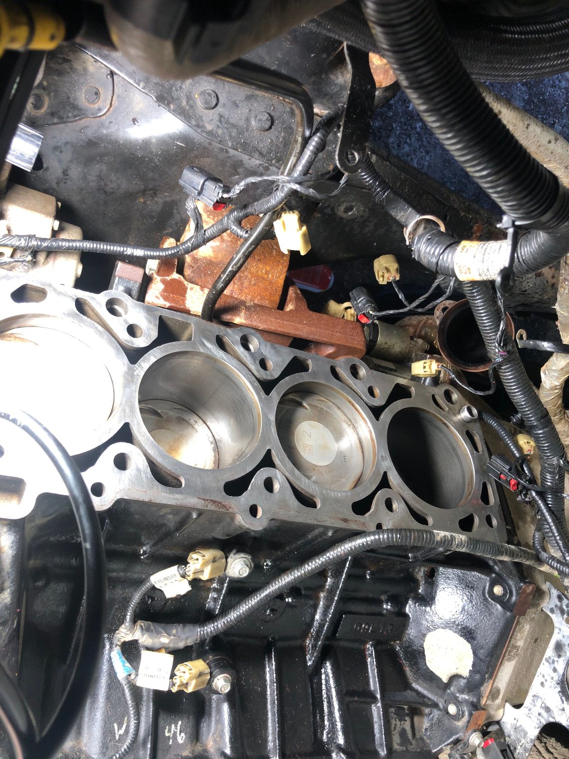

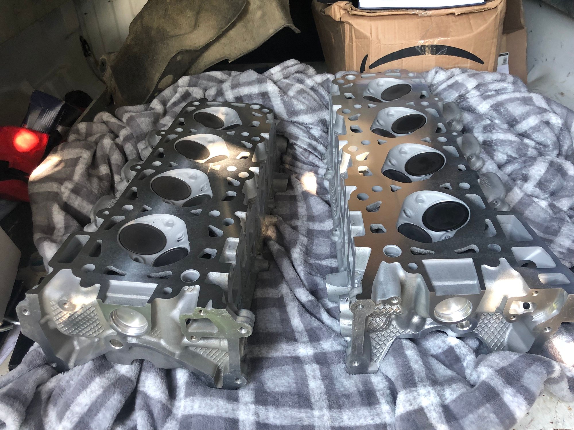

Side note (lost my post text) -- according to the machine shop I had five separate bent valves. Bent as in, the valve cutter couldn't even turn them properly. Weird because on visual inspection they looked fine, but according to the machinist, even a small deflection can cause serious performance issues at speed (which is, of course, exactly what was happening). Those valves are replaced, the heads are like new (again: cannot recommend JB's Aussie Machine in Burien, WA highly enough! Great work, fair prices), the block deck and front cover mating surfaces are prepped, and I hope to get started on the reassembly this weekend.

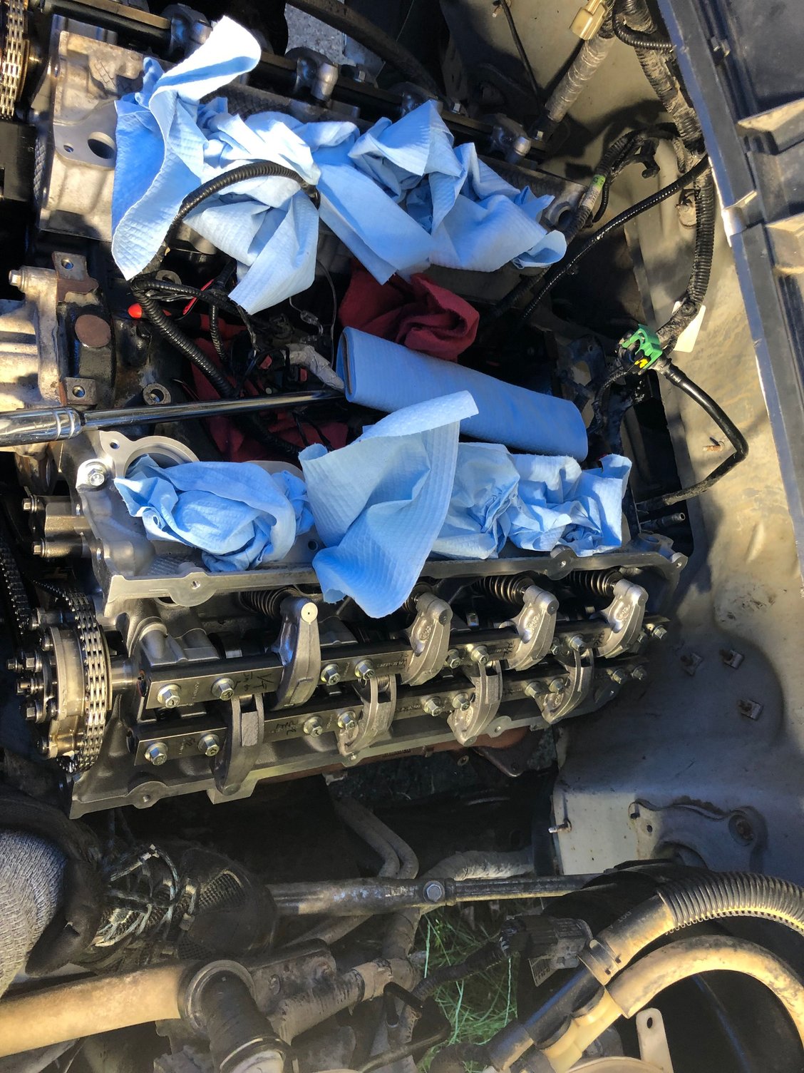

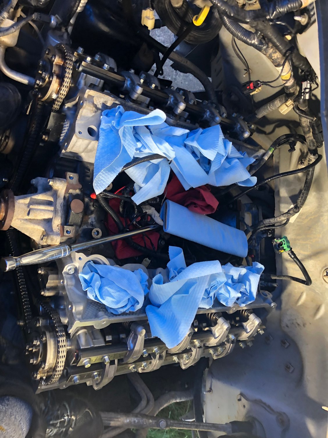

Heads in
Well I got the heads back in. Need to reset the timing and put everything back together!

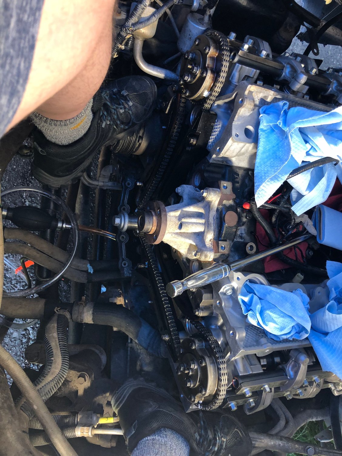

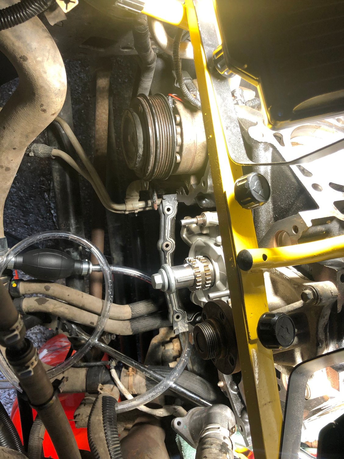

Timing In
Well I got all the timing gear in. Now… front cover, intake manifold, accessories, flush and fill coolant, refill oil… hehe… long way to go!
Got rags in the intake ports. Rainy PNW isn’t always friendly to open engine cavities…

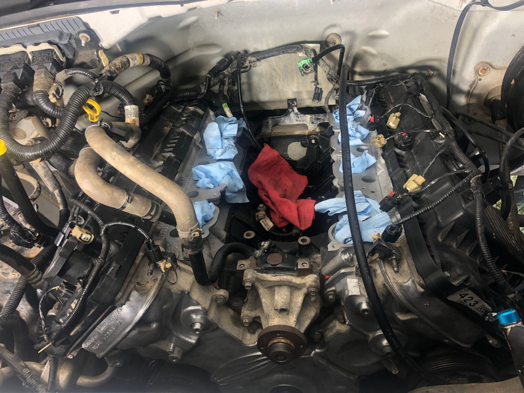

Closer
Mostly just need to put in the intake manifold, crank pulley, and accessory drive stuff.
Still got the intake ports blocked until manifold is in.
