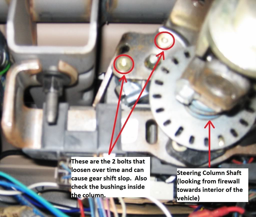

Check the 2 torx screws and the shifter column to see if they are loose
And also check if the shift tube isn't broken or the caps holding them aren't loose or have missing bushings.

My '01 Mexpedition did similar by how your description sounds...bad shifter bushings, dropped the MLPS into gear per the switch. Took either into neutral to light off or pushing more vertical into park. Two new bushings and snugging all fasteners eliminated this issue.
