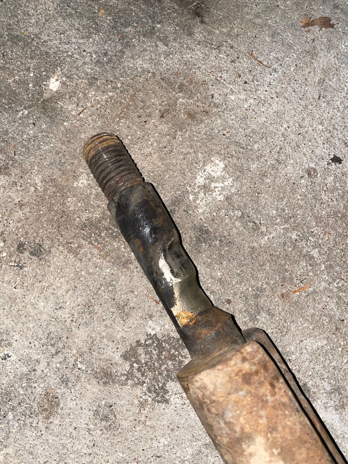

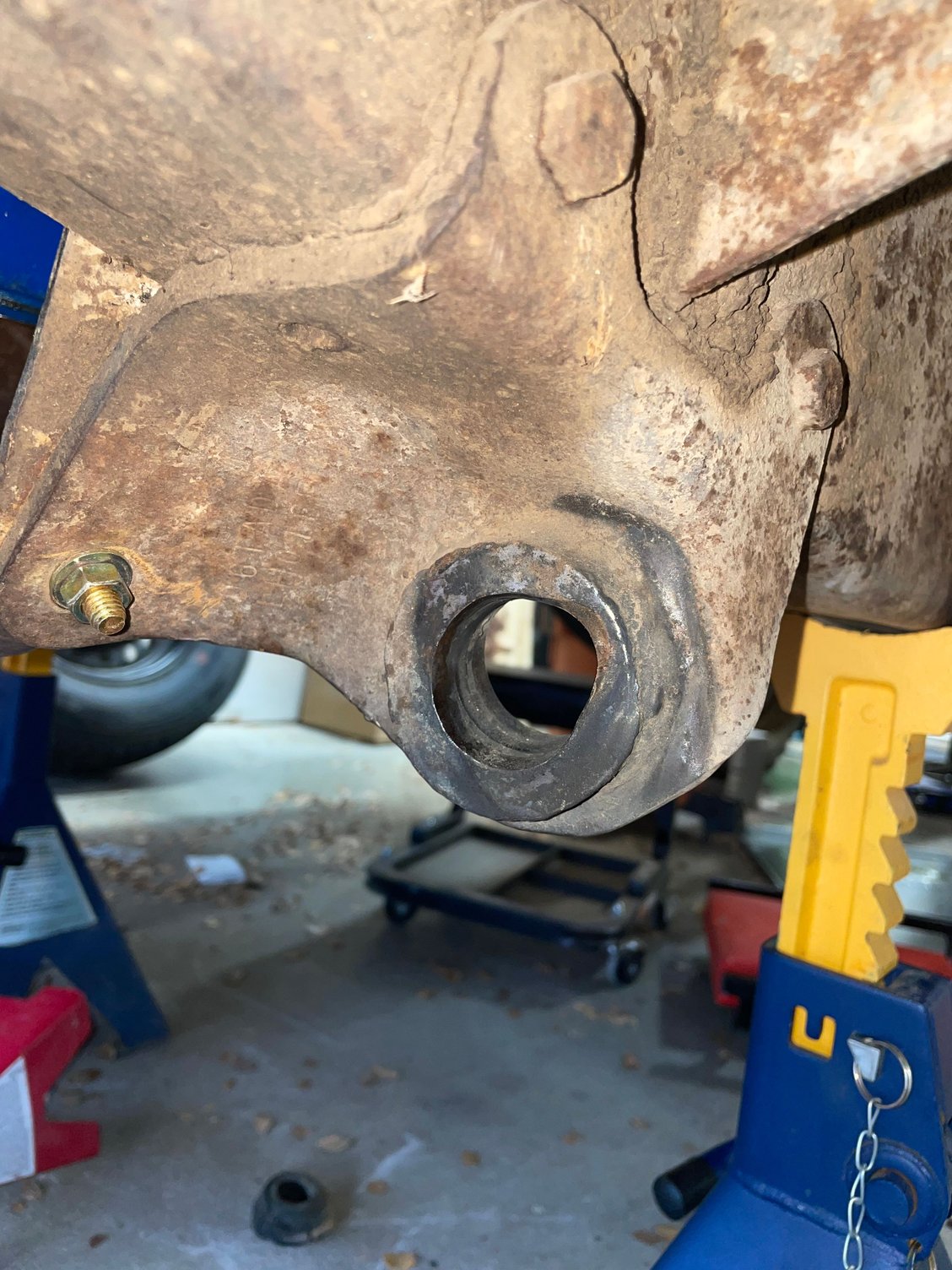

Hello everyone I have a 1977 Ford F-250 Custom 2wd I’m going to try and explain this as good as I can so this truck was a farm truck and you can imagine it had its beating im currently doing a restoration on it and im currently rebuilding the front suspension and I got it all pulled out today and found out my radius arm mounts and the arms itself have taken a beaten the mount is warped and the threaded area on the arm (pictures below) so I’m honestly looking for a repair option I have heard this is common if I’m not mistaken correct me if I’m wrong but I’m looking to see what I can do at this point if there’s any good solutions thank you

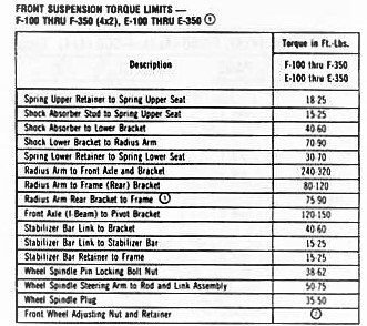

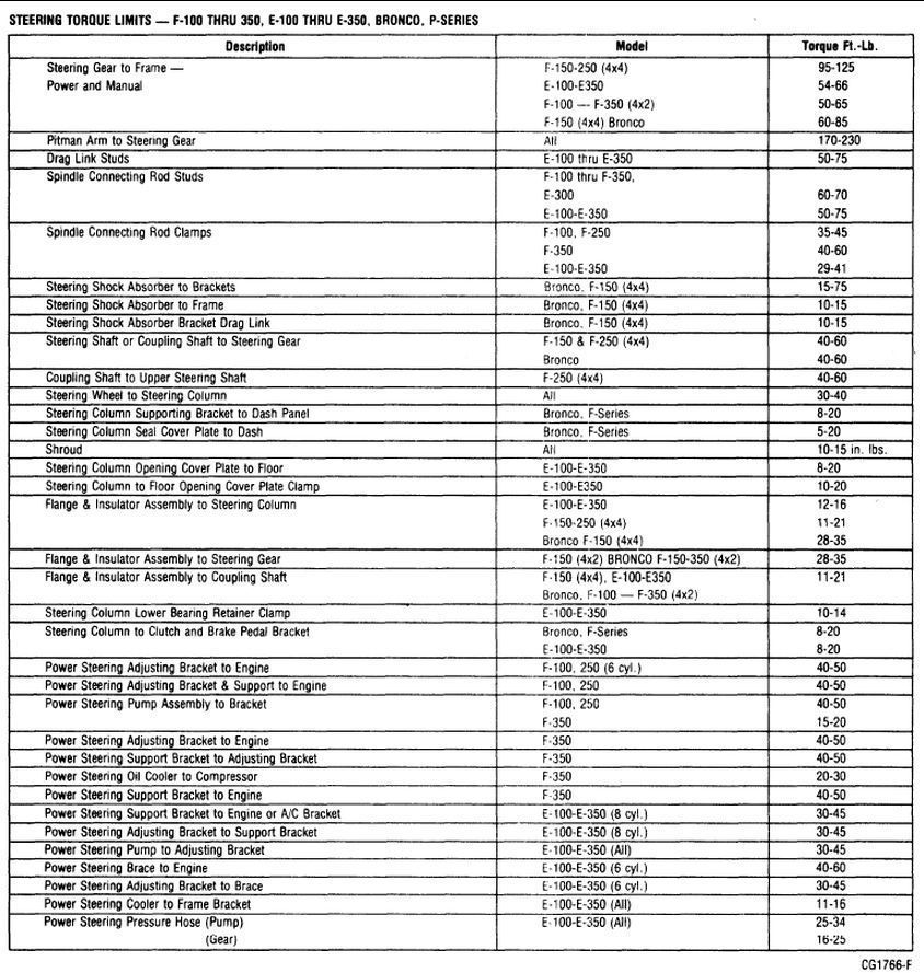

Also does anyone know the torque specs on all the bolts on the front suspension? Thanks

Swap with parts from another truck. Easy fix

i figured the fun part is finding a parts truck lol I appreciate the help!! Would it hurt if I just threw new bushings on it and see what happens?
Old Dec 26, 2021 | 11:39 PM
brian1080's Avatar
brian1080
Joined: Feb 2010
Posts: 1,742
From: Near St. Joseph,MO
It will eat the new bushings and will be a weak point.

damn I wonder if I could maybe find a pipe and weld it in there so it can bring back the circle and strength maybe

Keep a couple of things in mind, first; if you restore this I'm pretty sure it will have a much easier life than it was raised with. Also the radius arm is just holding the I beam from moving forward and back. It's not a bearing surface that has to be perfect.
I would buy a new arm, but if you can't find a used bracket, just weld up the bad side of the hole and grind it, drill it, file it, whatever you can do to get it fairly round and call it a day.
Old Dec 27, 2021 | 08:12 AM
77&79F250's Avatar
77&79F250
Moderator & parts slinger
Posts: 50,271
Likes: 5,824
X2 on I'd try and replace the radius arm mount bracket and the radius arm itself. But if I could not find either one, I would weld build up (just the worn out area) on the bracket and then grind, file, drill it back to its original round shape. Adding a piece of pipe inside it will change the inner diameter to much for the radius arm with the bushing to go back in.
I would try really hard to locate a replacement radius arm. If not, I would take it to a professional welding shop (unless you are a professional welder, like as in certified pipe line welder) and get those worn areas built back up. I would not just put some booger welds on that critical part of your suspension.
