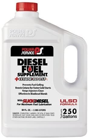

If I plan on traveling into a cold climate, I will start treating the fuel before I get there. For years, I ran this:
About two years ago I switched over to Opti-Lube XPD as I can run it regular strength all year around and if I drive into very cold areas, I just double the dose and it gives me plenty of protection... so far
