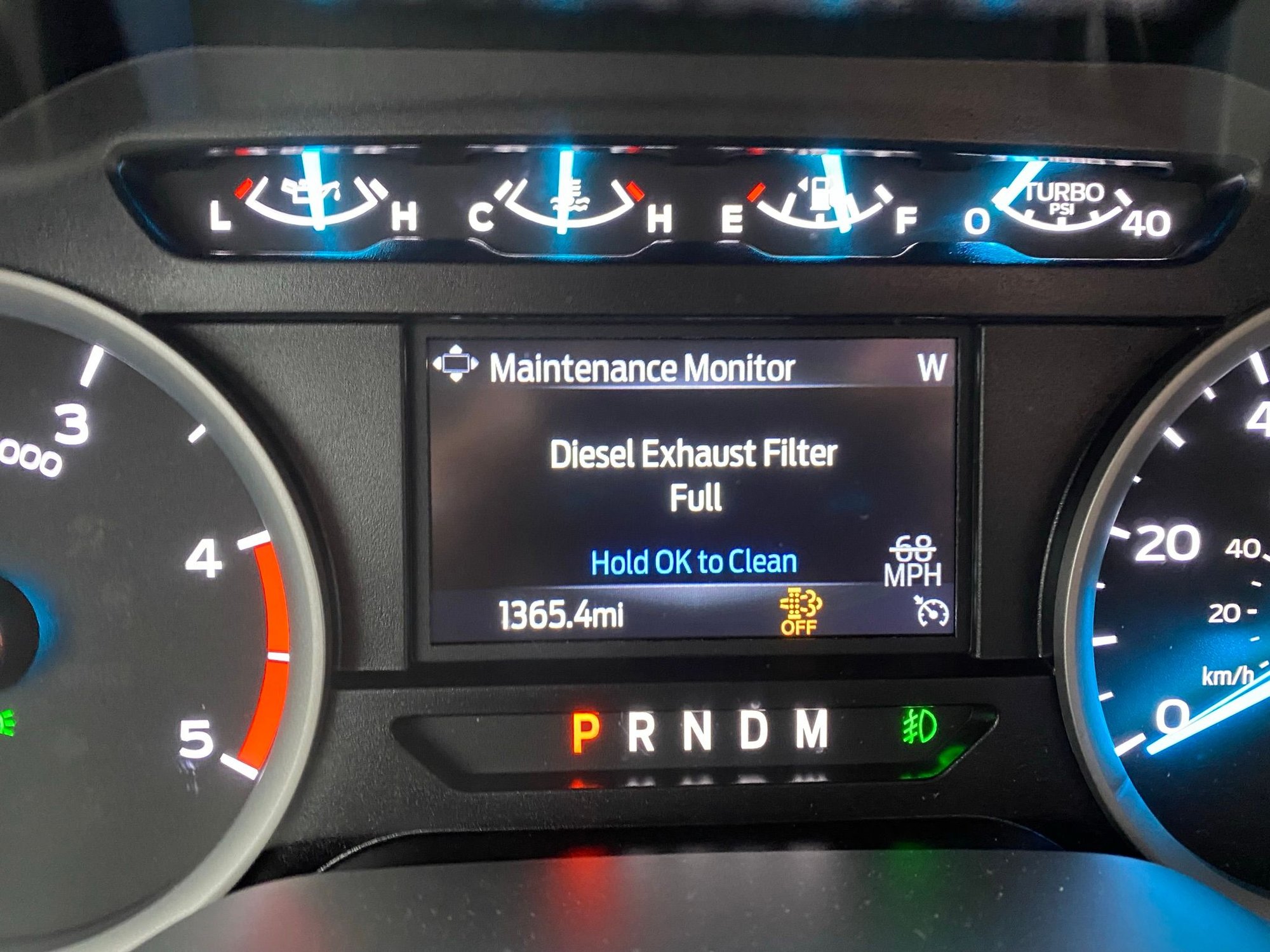

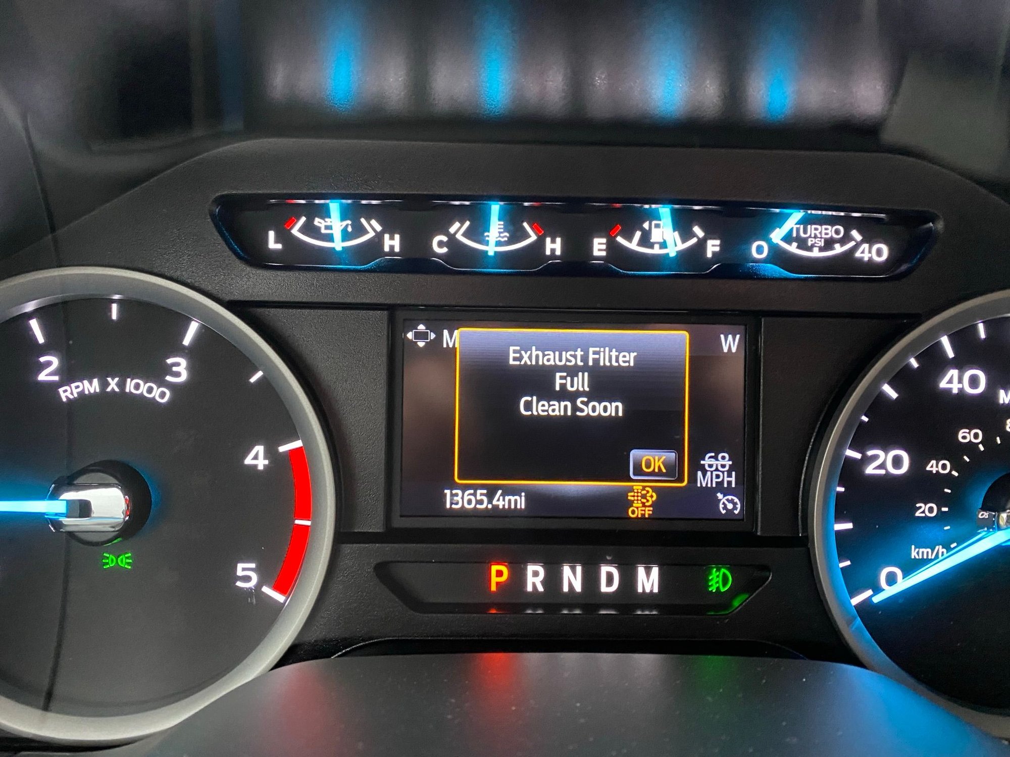

I keep mine turned off and watch the DPF%. I typically drive less than 4 miles one way to work every day, through 6 red lights, so there is no opportunity for the truck to really even get started with a regen, let alone complete one. By keeping the Auto Regen turned off I can wait until the truck reaches 100% and then just plan a longer trip somewhere, flip it back on and actually let it complete the regen. Much better than driving it around at full all the time and never allowing it to regen. If you are driving longer distances at highway speeds everyday, I agree, it's not as much of a concern. Just depends on your driving conditions/habit.

So, you don't turn Auto Regen on/off with Forscan. With Forscan, you are simply enabling or disabling the option to appear in your instrument cluster. So Auto Regen has actually been turned on in your truck. Another easy way to tell when Auto Regen is turned off is that every single time you crank your truck you will get a notification letting you know it is turned off and you have to hit OK to turn the notification off. If you want to turn it off, you will need to go back in with Forscan and enable the Auto Regen to show up in your instrument cluster. Then, once you enable it, you will need to go into your settings in the instrument cluster and uncheck the Auto Regen box.

Thats incorrect, my auto regen is turned off/disabled, so my truck won’t regen unless I turn it back on. But yes, I also have my DPF% enabled too. Auto regen and DPF% are 2 different things. When my DPF% hits 100 I get a notification that my exhaust filter is full and I need to clean it soon. If the auto regen wasn’t turned off I wouldn’t get that message and the truck would automatically go into regen once certain parameters were met. So, when I get that message, I get on the highway and turn the auto regen back on and soon after the truck regens.
As far as what “full” actually is, I have no doubt that when the dash reads 100% that it is actually 100%, but instead just a benchmark that first notifies the user that it needs to be cleaned soon. And this notification pops up because the auto regen is indeed, disabled.
