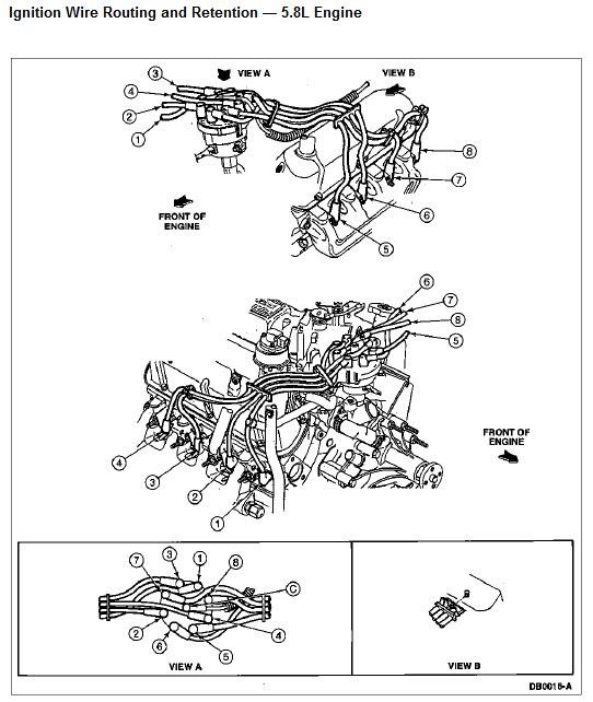

I have a 97 Ford F-250 5.8 L motor I just replaced the starter the wiring and the spark plugs what put in because the original owner and it was a 98 instead of a 97 and I need help getting the wiring diagram for the spark plugs and wires

@NinaD

That looks a lot like my 66 GT 390 ignition. ......
Old Dec 22, 2021 | 09:30 PM

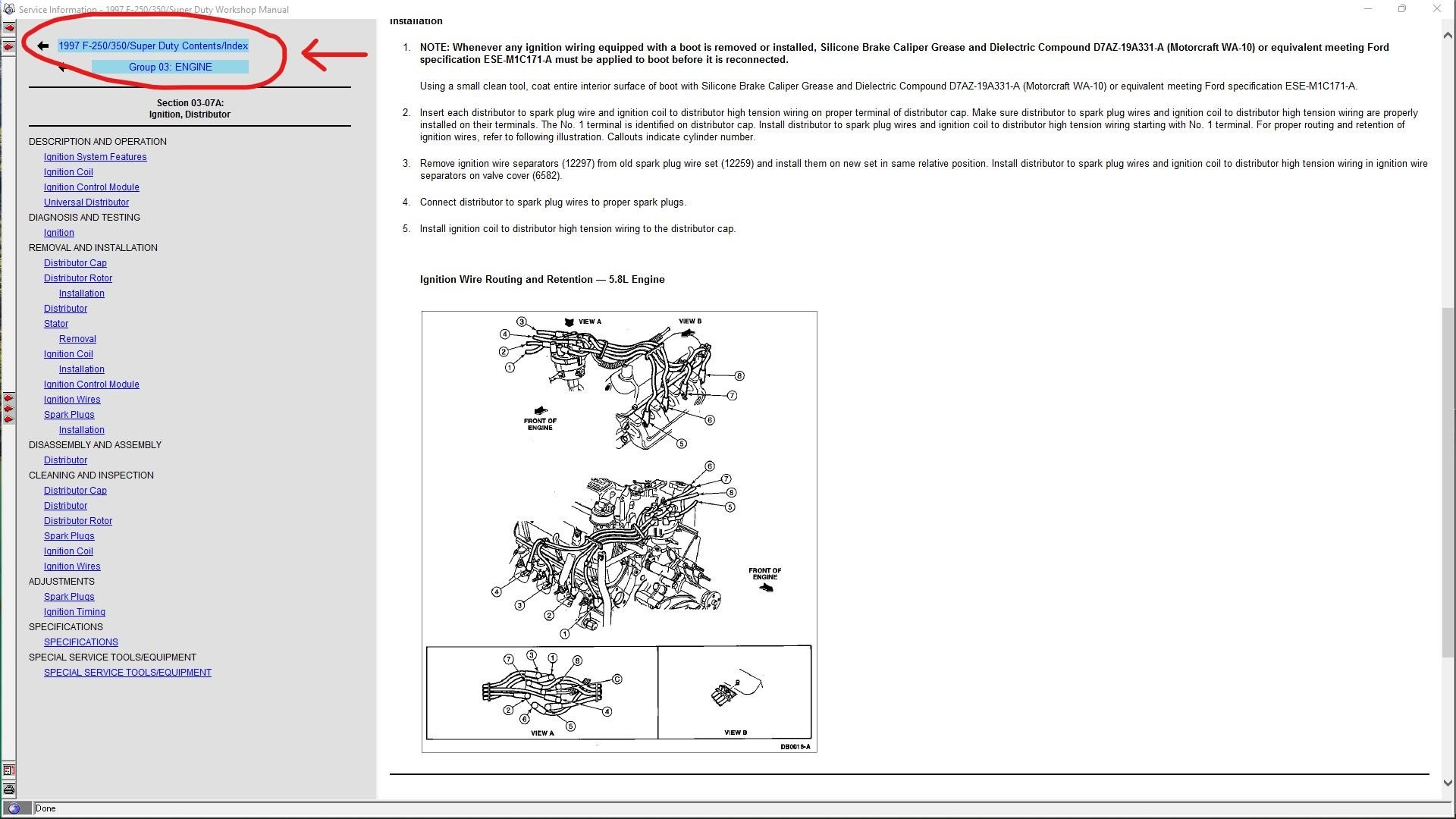

RLXXI's Avatar
RLXXI
Joined: Nov 2020
Posts: 7,128
Likes: 1,945
From: Sportsman's Paradise
Old Dec 22, 2021 | 10:21 PM
Papa Tiger's Avatar
Papa Tiger
Joined: Mar 2012
Posts: 26,204
Likes: 4,151
From: Near Cal. Avenue
There it is ! Thank you ! Still looks like the 66 GT 390's ......
