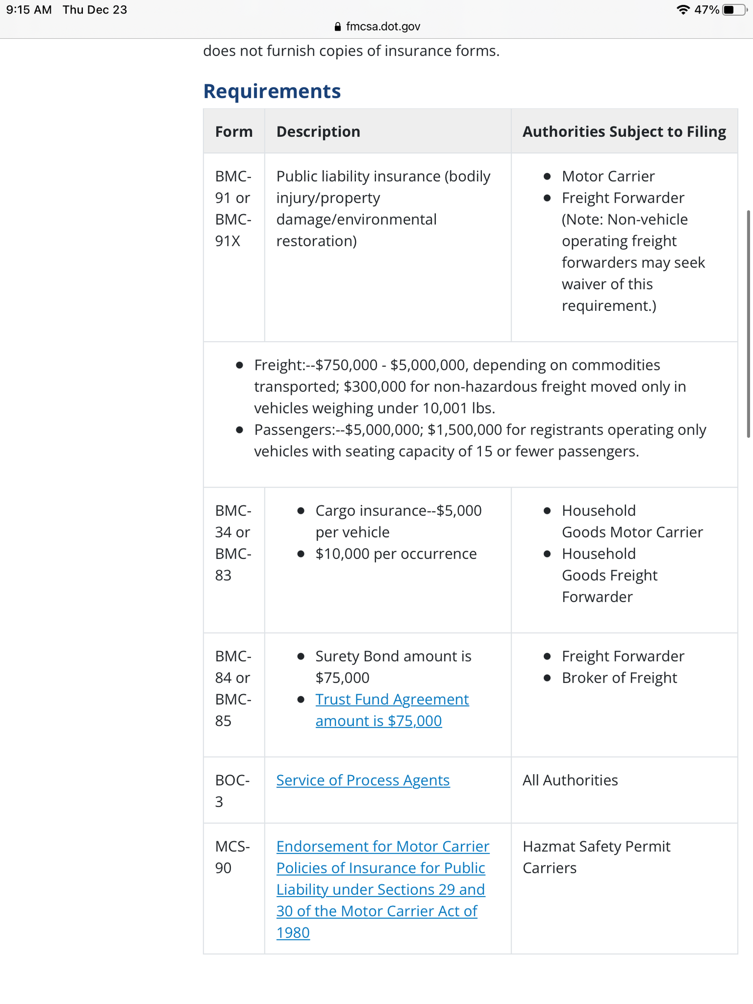

senix is correct, for the most part.
To go a little more in-depth, it’s a two-part reason. The rules are different for liability minimums, between regular vehicles and interstate commercial vehicles. The $750,000 minimum, for interstate commercial motor carriers is liability against property and personal injury, not cargo coverage. Most companies want a million dollar liability policy, or they won’t hire that motor carrier company. Compare this to the Kansas minimum liability coverage of $25,000, for a passenger car.
Cargo coverage is not required, by FMSCA (that I can find), except, for anyone carrying “household goods”. However, when you get a $750,000+ intrastate policy that meets the requirements to complete a BMC-91, the policy will usually include or have an option to include a certain amount of cargo insurance. After all, you wouldn’t get the policy, if you weren’t hauling cargo. What most guys I know do is carry a normal amount of cargo insurance and if they get a load that’s worth more than their regular coverage, they call their agent and pay a few dollars for the extra coverage. After the run is over, they let their agent know and that part is removed.
For the OP, let’s say the horses he hauls usually are valued at $5,000. Just made up numbers, for an example. It’s likely a $750,000 policy is going to be enough, for his customers and meet Federal requirements. Let’s say that policy has a $10,000 cargo coverage, so long as it’s not haz-mat, passengers, or household goods (which are all in different categories than general cargo). Day in and day out, he runs without issue. One day, he is asked to transport two horses valued at a combined amount of $25,000. He decides not to up his cargo coverage. He is involved in a collision and both horses die. The Feds don’t care, he had the minimum coverage required to operate. The customer gets a check for the $10,000 the OP had coverage for. The remaining $15,000 value lost is a civil issue, between the customer and the OP. Therefore, smart customers will make sure the cargo insurance meets the value they place on the hauled cargo. The OP would have been ahead giving his agent a call and informing him of the necessary change in cargo value, for a given time period.
This is my understanding. Also worth a note: some animals, including some horses for certain uses, are exempt from some regulations (such as needing interstate Authority), but the insurance requirements aren’t exempted. The OP will want to thoroughly check into this, if he’s going to try to fly under any of the exemptions.
https://www.fmcsa.dot.gov/registrati...g-requirements
