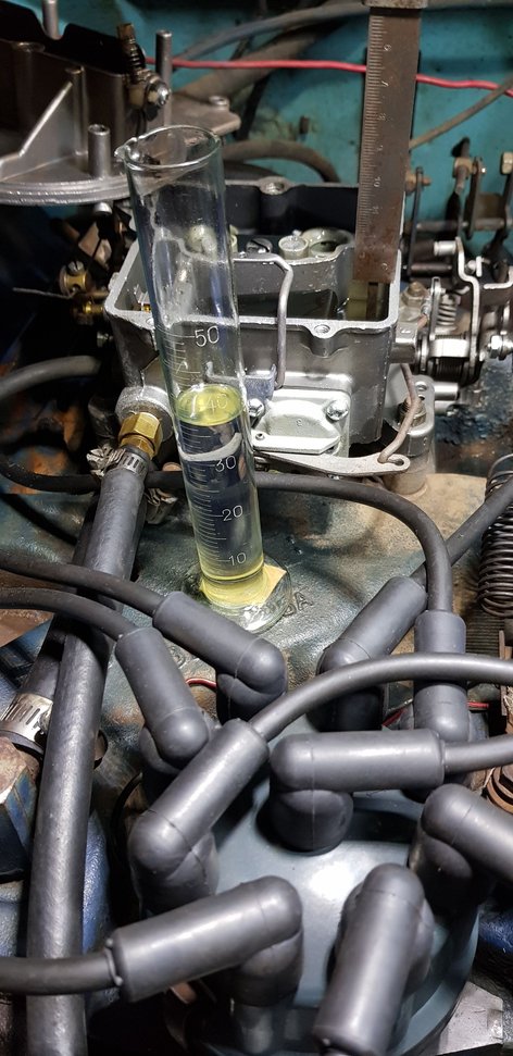

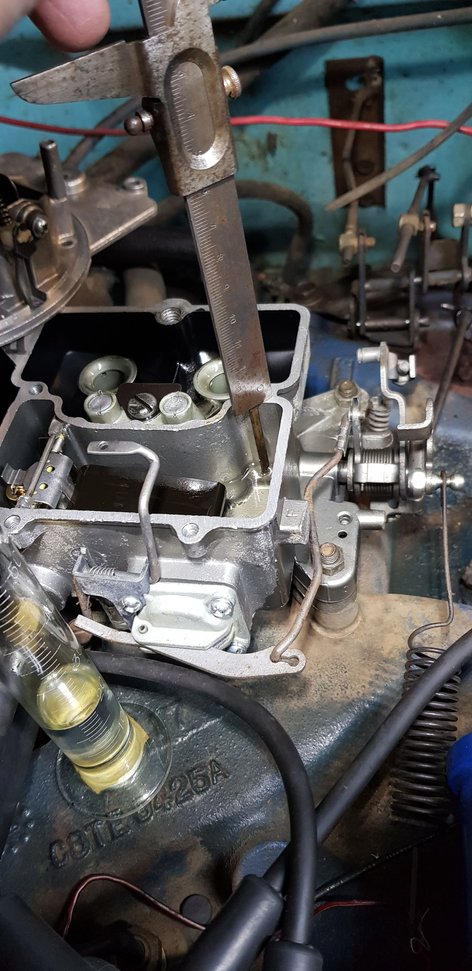

Ever since I bought my '68 F250 it was hard to start, and became even more so as the temperatures went down recently.
Sometimes I would have to crank until the battery almost was empty.
Putting some gasoline or brake cleaner into the barrels seemed to make it easier.
Today I was checking the float level (wet), it was 3,33 cm (ca. 1 1/3 inches)
Probably that would not produce enough fuel pressure for starting.
Old Dec 19, 2019 | 05:50 PM
uschi67's Avatar
uschi67
Joined: Nov 2019
Posts: 49
From: Juchte
Since the engine was not running I blew air through the fuel hose to check when the float would close, bend the float higher and then add fuel until it would close again.
Repeated 2 or 3 times until I reached a wet fluid level of 2,39 cm (ca. 0.940 inches)
Started the engine a few times cold, then warm and found it to be much better, engine starts within 1-2 seconds now.

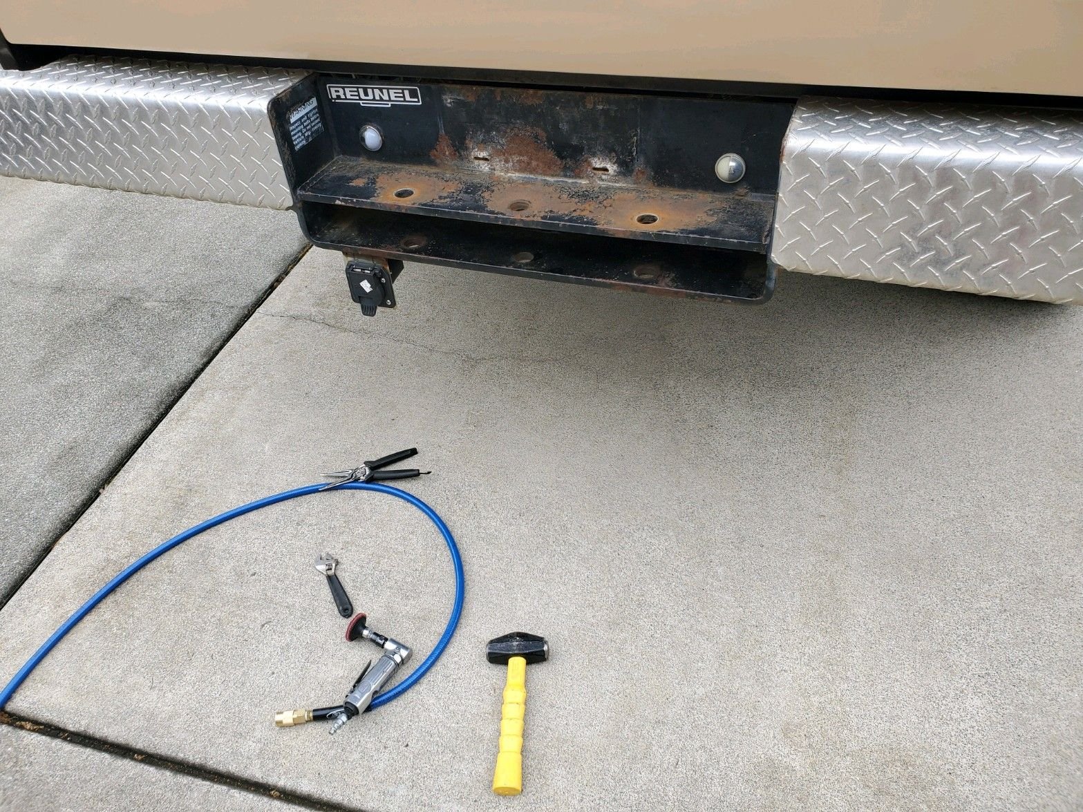

Sundays project

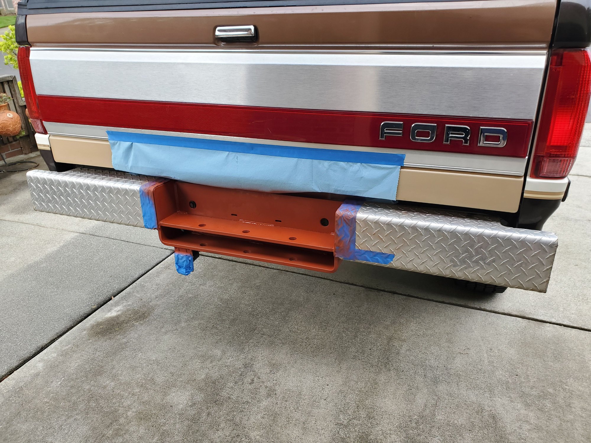

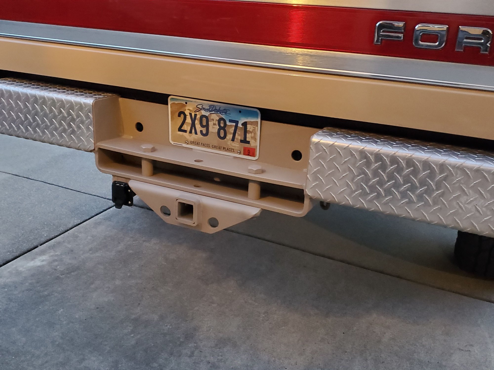

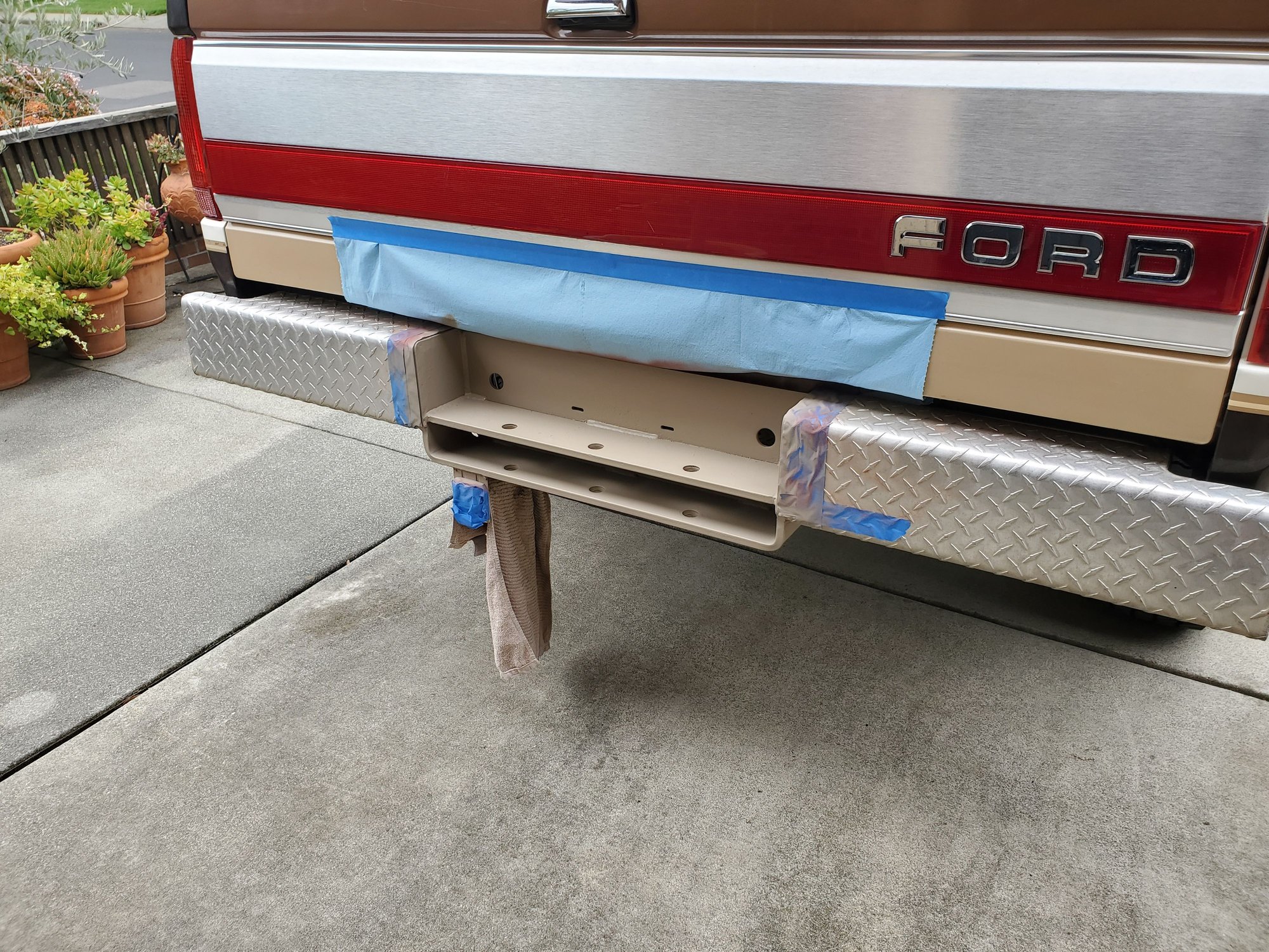

The Reunel step bumper was a crusty mess so it received a refresh on Sunday. Ever wonder why there are so many people from South Dakota in Baja? There aren't, South Dakota is one of several states that allow you to title your vehicle there wiut having set foot in the state. 70,000 vehicles wear SD plates that reside somewhere.

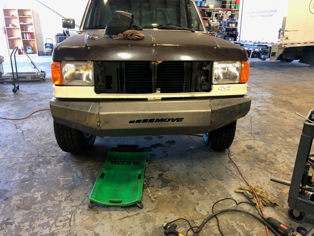

I put one of my members whose Jobsite shut down because of distancing rules to work this week assembling a bumper kit for my F250.
