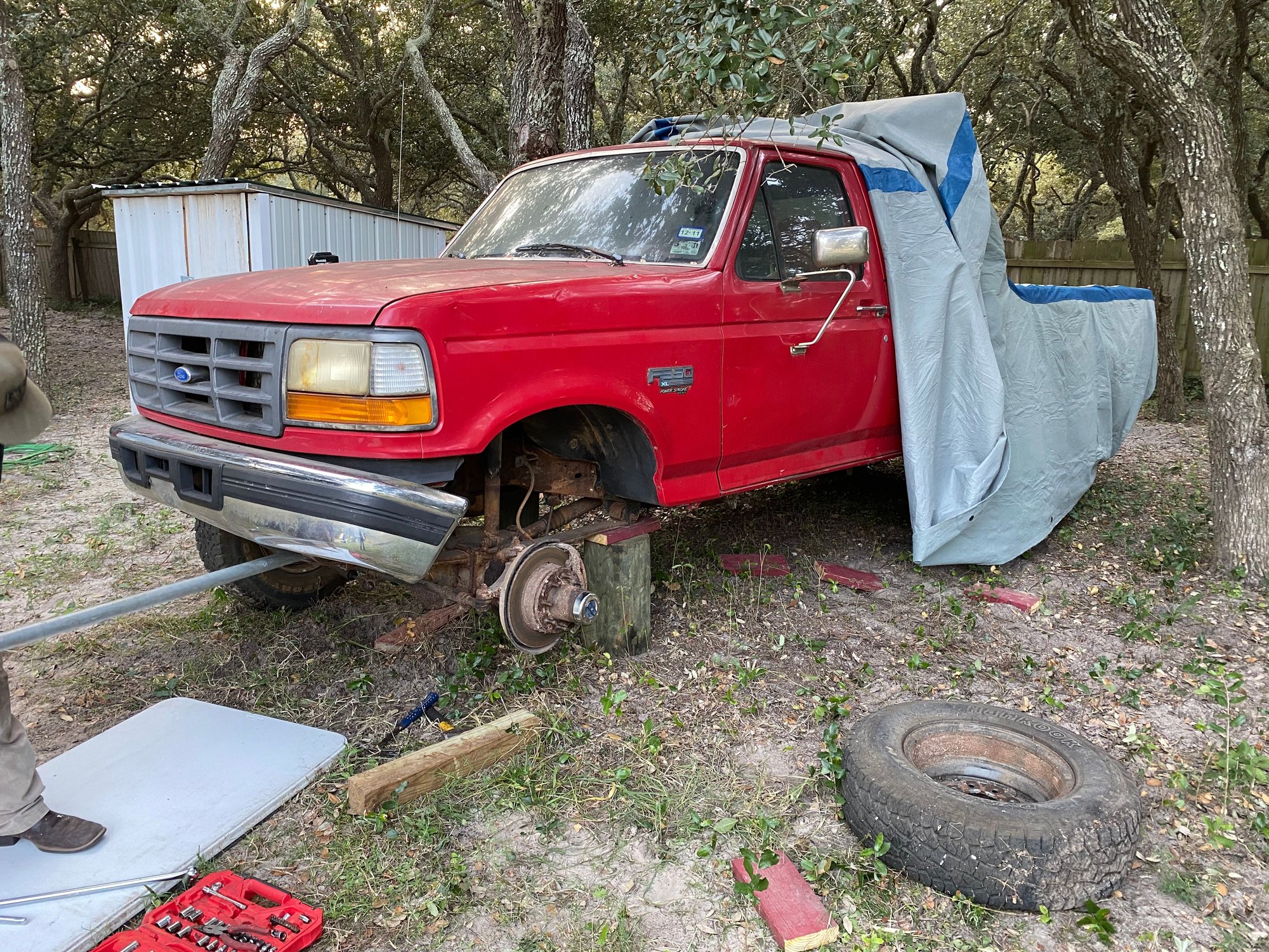

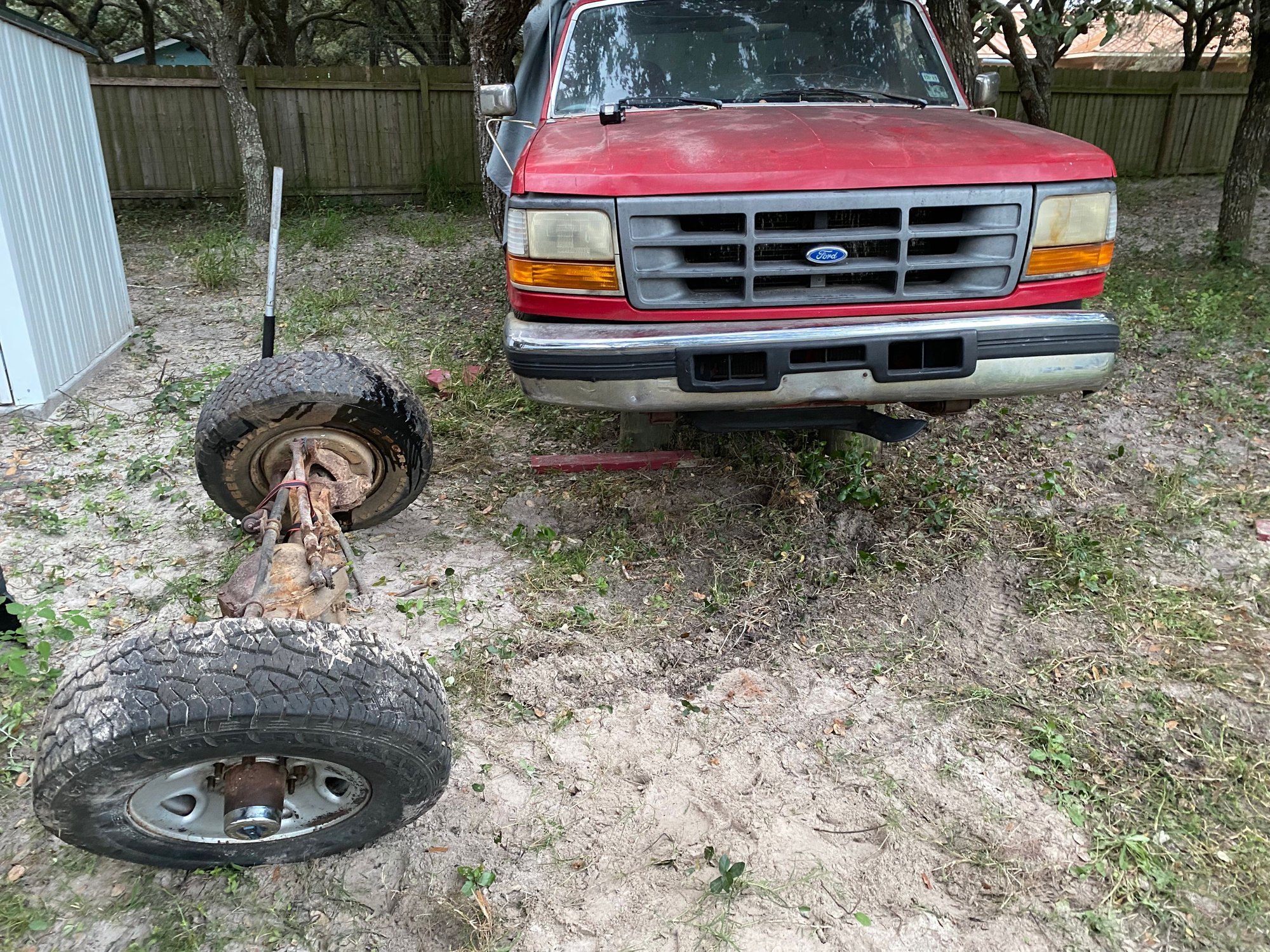

Project officially underway! The 60 needs new ball joints, U joints, inner seals, brakes and just overall de-rusted!
Tie rod end, “with enough leverage I can move the world” 🤣
