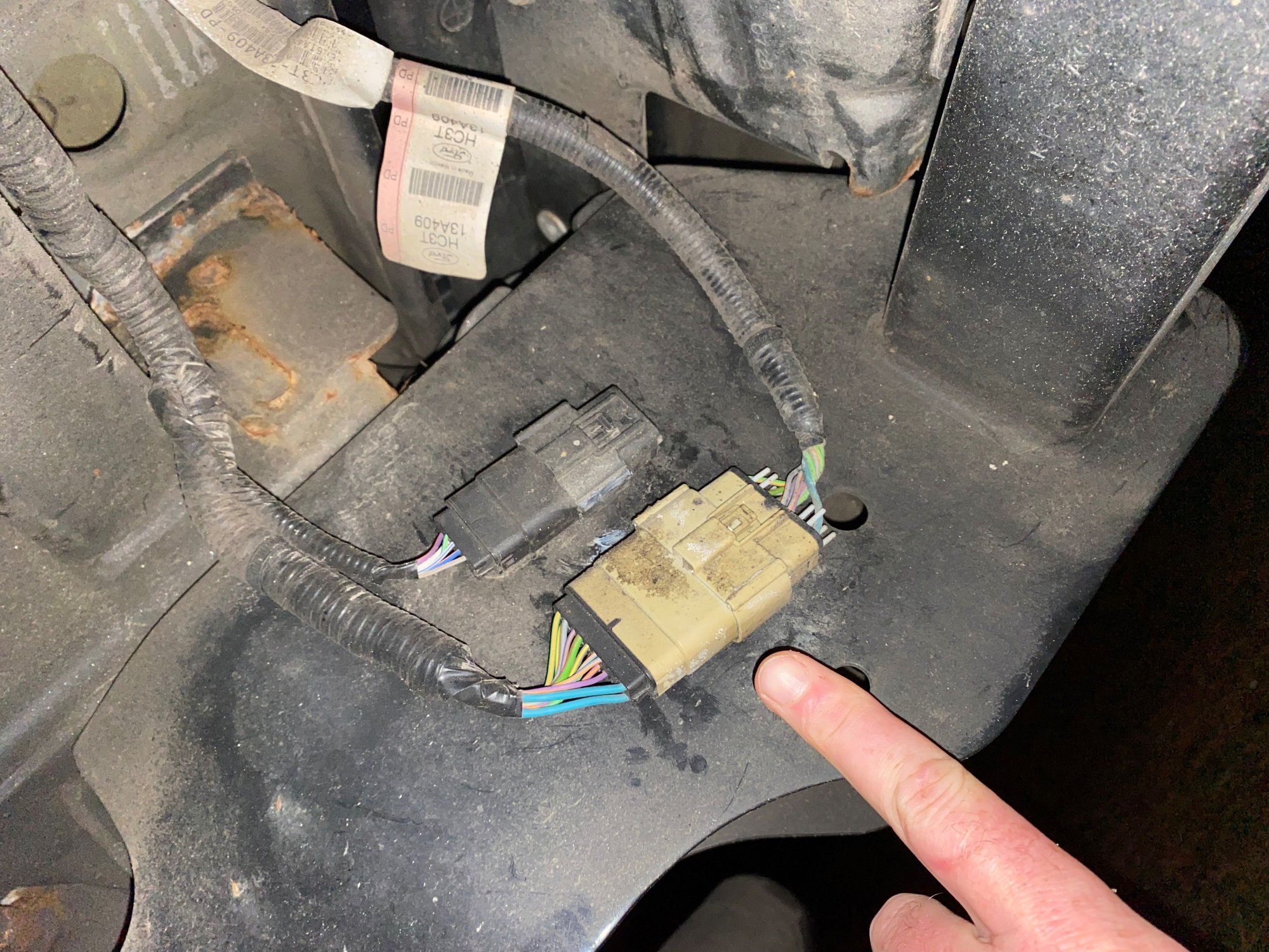

There's a connector on the passenger side frame up under where the spare sits, it's notorious for getting water intrusion and corroding then wreaking havoc. Even if this isn't the issue you should disconnect, clean, and dielectric grease it.(along with every other plug under there....)
Worth a mention anyways....
