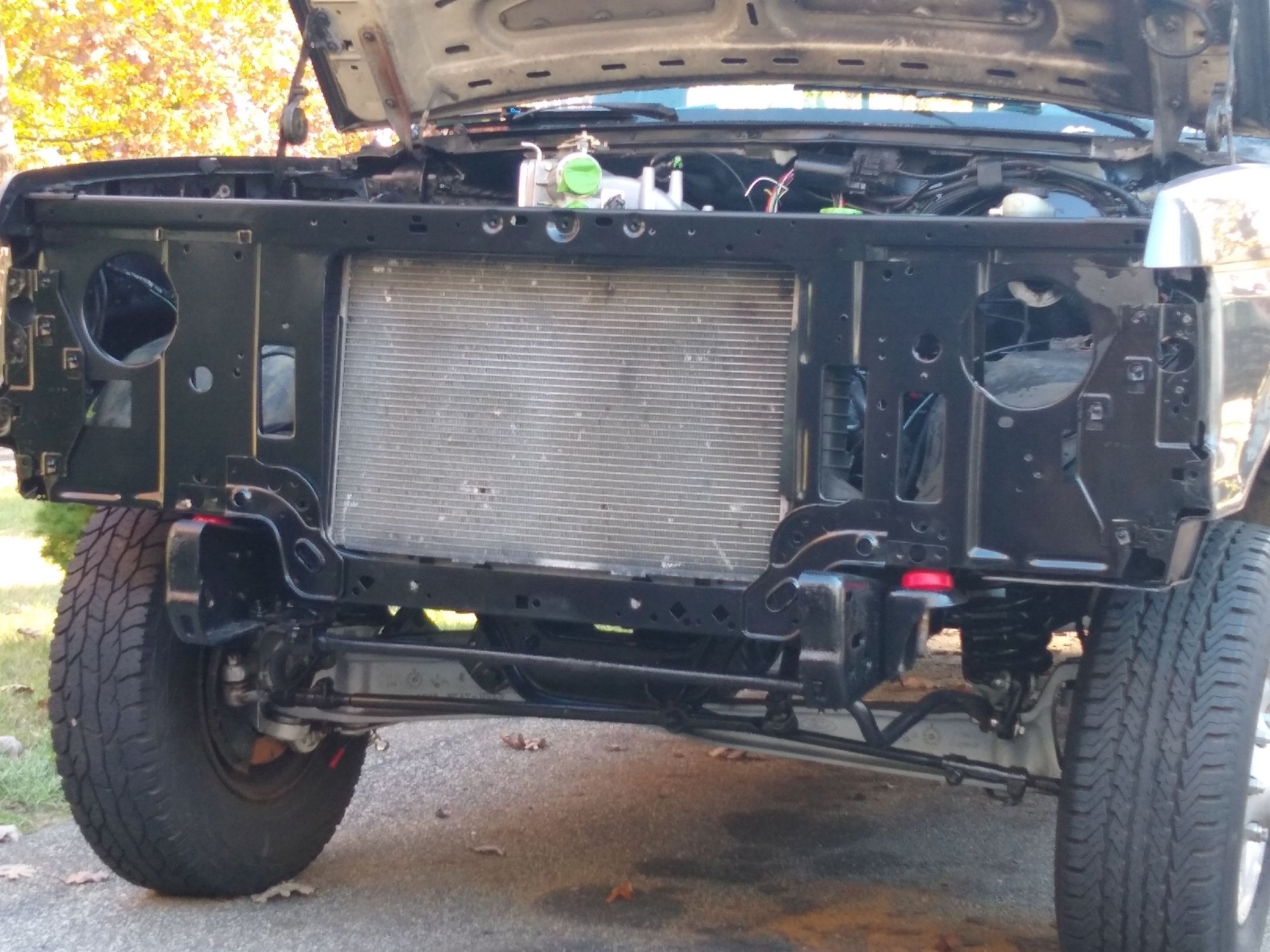

Your radiator is mounted to your radiator support therefore I would deduce that your rad support along with support bushings and maybe even frame mounts are so rotted it cant support the radiator rigidly enough anymore...Take a block of wood and a 2 ton jack and jack up under the radiator support to see how bad it is...
Mine was rotted and damaged from a crash sometime in its lifetime before I got it then weakened as it rusted away but I will tell you that doing both will be a hell of an improvement once you do them...
I used to get alot of feedback through the wheel and the frontend always shimmied a lil and the cab rattled pretty harshly.
When I did my total refurb I ripped the frontend off and noted all the damages to the rad support aswell as the body cushions..Its a good thing my front cab supports werent rotted but my rockers and cab corners were and that caused the cab to flex and caused the windshield to leak..I bought another truck for a better cab and although the rockers were stellar the cab was more worse than mine so I had to do the laborous task in replacing both sides of the rockers & cab corners also doubled-up on the floor pans under both feet too...
I used lots of paper towels from the dollar store and a 5 gallon can of Evap-O-Rust along with shrinkwrap to derust everything down to bare metal then epoxy painted the parts with VHT Epoxycoat then recoated again with POR15.I was tempted to powdercoat using a flame applicator but it would of been too risky also very time consuming for the time of the year I was doing it which was this time last year...LOL
I bought premium silicone body cushions from SB Filters and a new rad support from crash n rust........Best part about the body mount kit is they also supply the tools needed to extract the old ones so no extra fabrication of making removal tools makes doing the job alot easier.....

@Surgemaster1277 That turned out fantastic! My pickup doesn't have any rust/rot on the body or front end area, so I don't think that's the cause. I actually have a new set of poly cab mounts sitting on the passenger seat. I started installing them, but couldn't get the old ones out with the tools I had. Do you know if the removal tools are available separately? Could I talk you into selling or loaning your removal tools to me?
