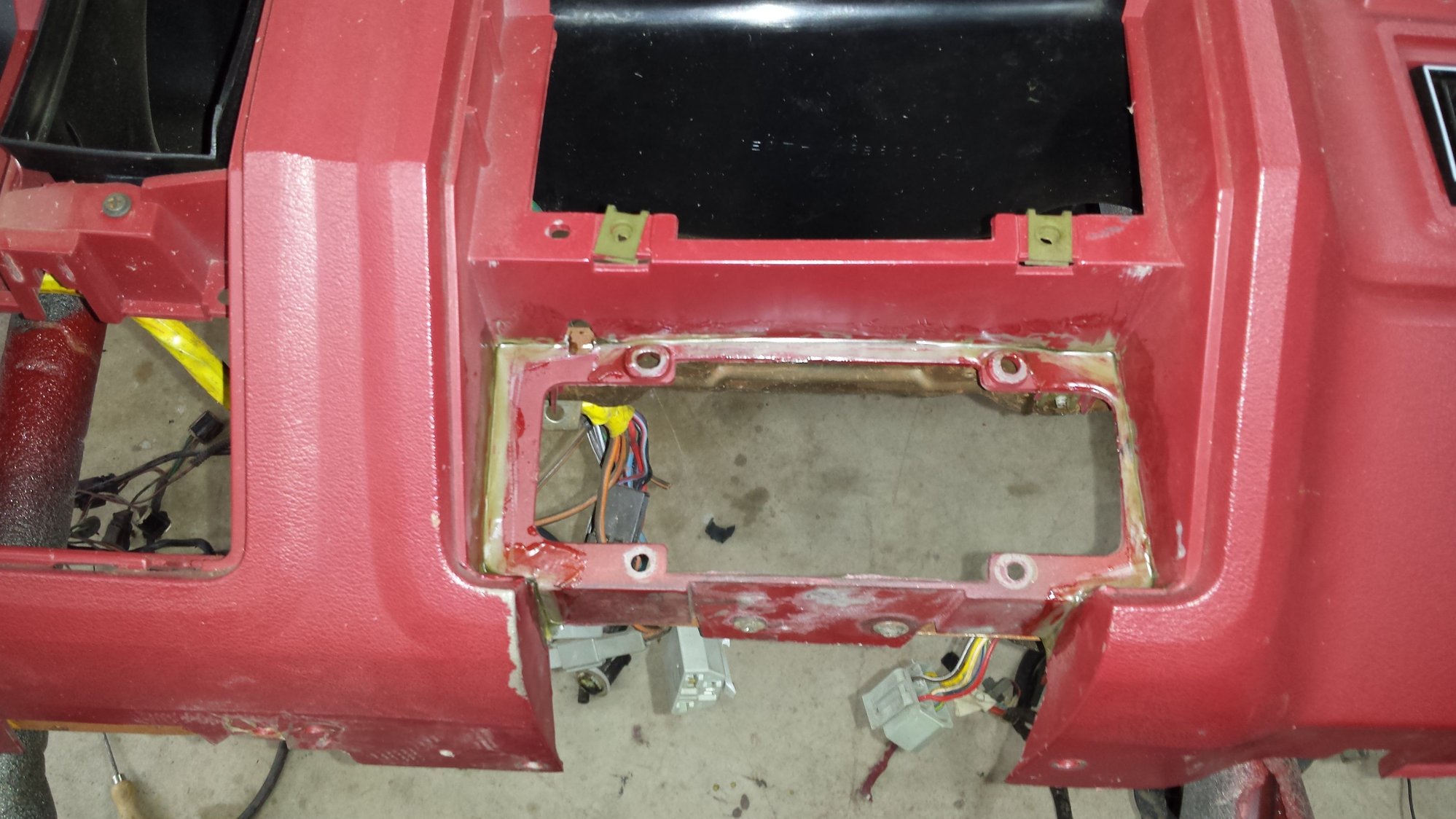

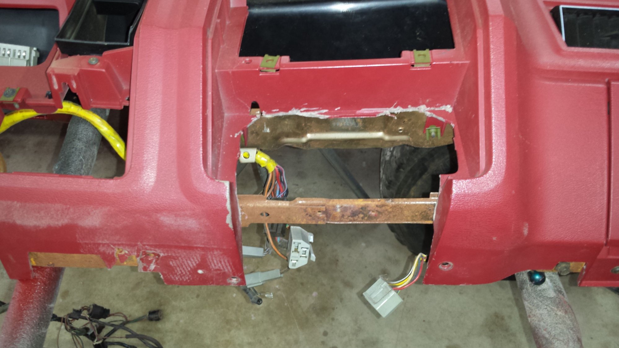

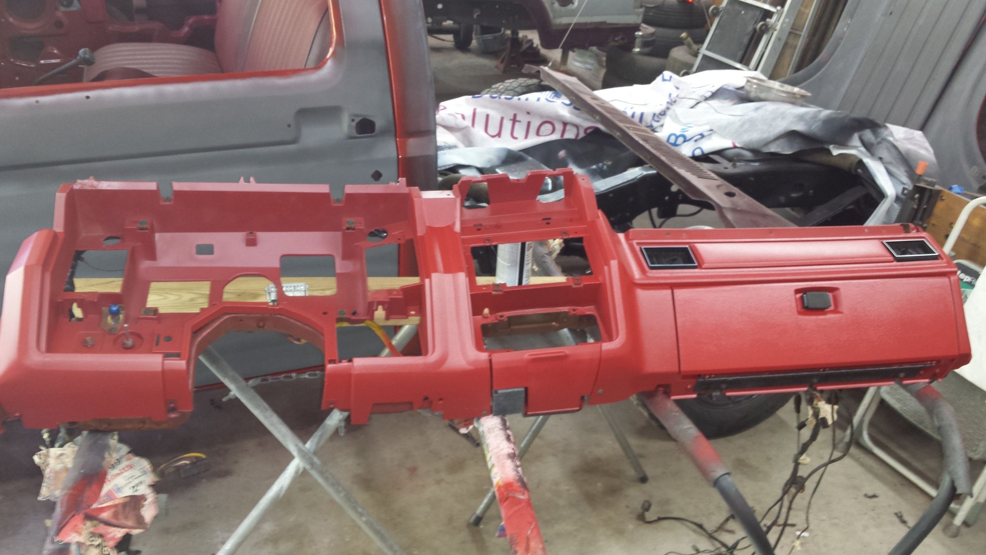

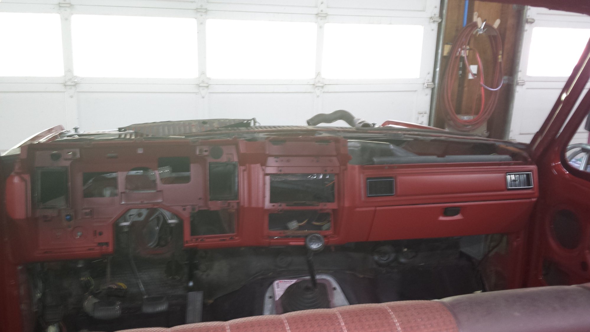

When I took mine out to swap into a different truck I took the whole dash with vents (AC dash) and wiring harness as 1 part. It went into the other truck the same way.
This is it sitting in the parts truck. I had to do some repairs to the dash plastic part before it was installed in my truck.
Broken dash
Fixed dash
Painted with SEM paint made for this
Installed

Looks great, guess I'll have to just take pictures of where it all goes back fasteners and such. Thanks for pictures Dash looks fantastic
