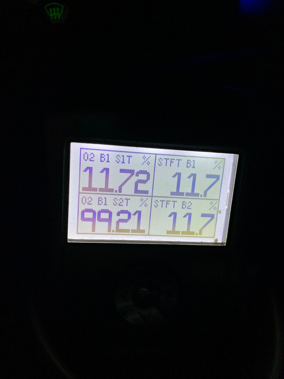

Looks like second O2 sensor is done (bottom left)? Stayed at that number the whole drive

Well, fortunately/unfortunately that reading for O2 B1 S2T is normal. It is confusing to say the least.
Your short term fuel trims look good.
I would pull up the PID's for the MAF, checking voltages at hot idle (0.7V to 1V) and Key On, Engine Off (0V), however seeing those fuel trims make it look like it will be OK, but it is worth trying.
Other than that, I would be interested if there are methods for using a scan tool to determine if there is a way to validate a particular cylinder is not firing correctly (i.e. Power Balance test, which I have still yet to find out how to do)... Can you say that this is a dead miss or just a slight miss?

is it normal for the o2 b1s2t reading to not change at all, regardless of throttle position or load? What do you mean by dead miss or slight miss?
