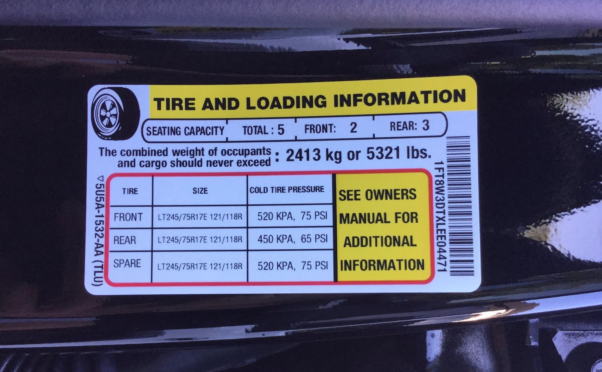

Here’s the sticker from my 2020 F-350 DRW 6.7 CCLB 4x4 Lariat

rember that yellow sticker is not the true amount. You have to get it on the scale and determine the load over the axles and then use the white sticker for the axle ratings.
Axle rating and tire rating ..don't exceed either of those whichever is less.
