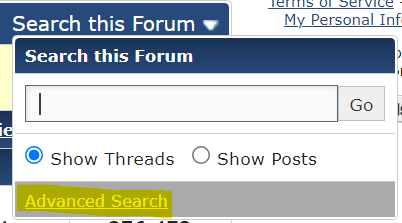

go to "advanced search" near the top right corner and type shorten bed...you will get many threads in the result...

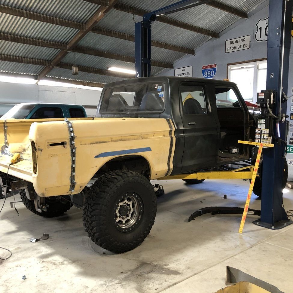

I've shortened two beds but never a dentside. On both I cut about 1" back from the edge instead of trying to make a nice bend for the front corner. There are photos in my thread on my 66. A dentside only needs the front cut for the difference in wheelbase.

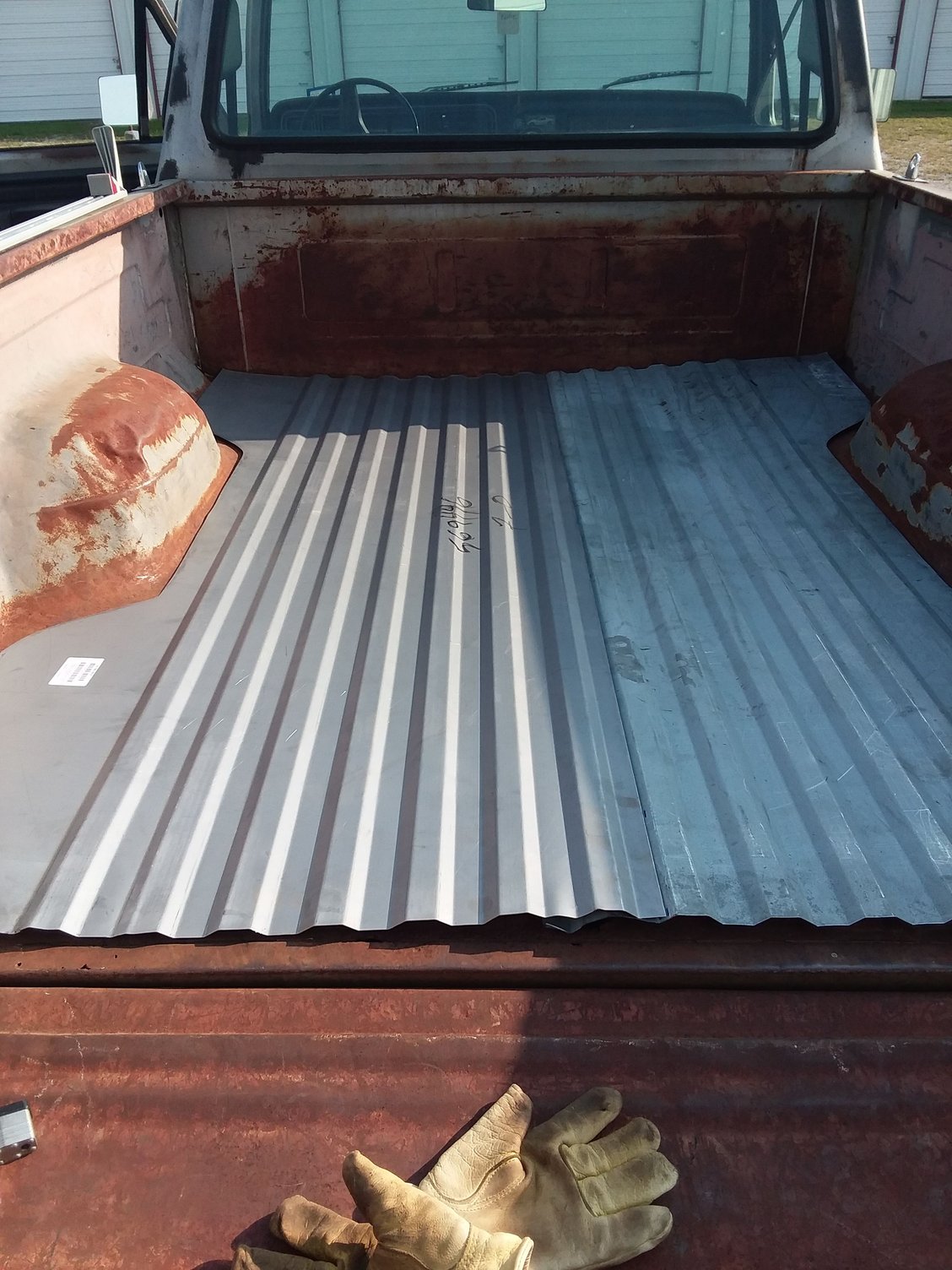

Are you wanting to make a long bed fit on a short bed frame or shorten a long bed frame and make then make the bed match?
At some point in time we will repair our short bed by patching the exterior panels and cutting down 2 long bed floor patch panels.
Here are the bed floor panels we purchased. (one from NPD and the other from Summit) They have already been cut to length.
We contemplated buying a long bed and cutting it down as described above, but it just looks so labor intensive, plus we had a hard time finding one at a reasonable price.
