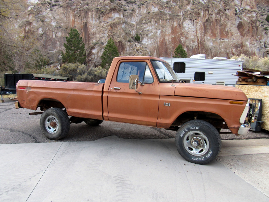

From: South Central Utah
What was the last year Ford used split rims??
I have a 1976 F-250 Custom 4-wd, would or could it have come with split rims?

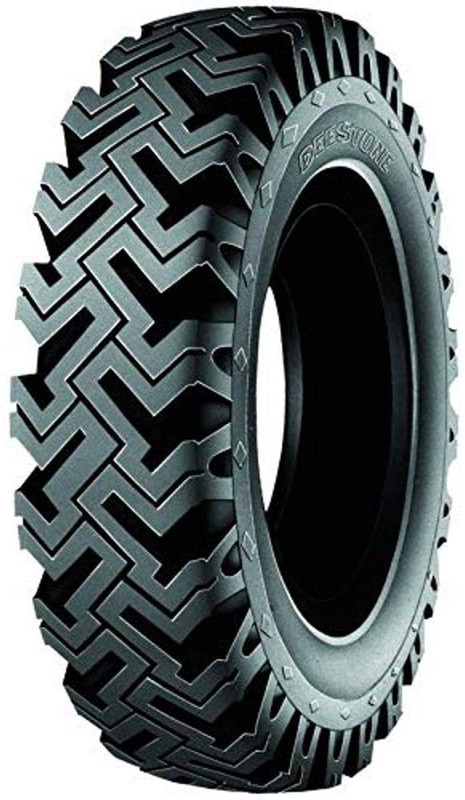

Originally Posted by DB429SCJ
I bought a 1976 F-250 brand new. It came with 7.50-16 D 8pr tube-type m/s tires on split rims. Not sure of the last year Ford used them.
Thank you. Then that's what I am going to find for my 1976 F-250 I just bought a few days ago.
The above tires are what I ordered for it in 7.50-16.

My first 77 highboy purchased in 1979 with 15k miles had split rims. I think the end of the "highboy" ended use of split rims on F-250s. Do not recall back in the day nor recall ever seeing a late 77 F-250 with split rims. My brother bought a brand new 78 f-250 and it had white 16.5 tubeless rims. Even by 1980/81 in-stock tire choices were getting limited for the splits and tire shop workers would run and hide when I'd pull in and they'd see the split rims. I swapped the splits for my brothers 16.5 steel whities when he got new 16.5 chrome spokes and big tires.
If you get a Marti report for your 76 and it says it had 7.50 x 16 tires then it had to be split rims as that was the only 16" wheel that was offered. see example below
