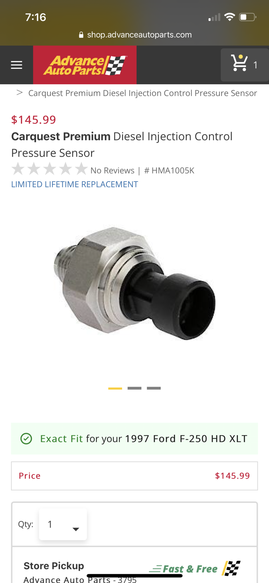

Big red flag on ICP if it's not an OEM FoMoCo or Navistar sensor. Is the IPR and the CPS a store bought sensor as well?

This is the one I bought

Rule of thumb with the 7.3 powerstroke is to always buy OEM sensors from a reputable source, if it were me I would buy OEM sensors then start trouble shooting from there, our engines don't play well with aftermarket sensors.

Idk why I didn’t go to riff raff in the first place they charge the same amount for the ford icp as I paid for the knock off
