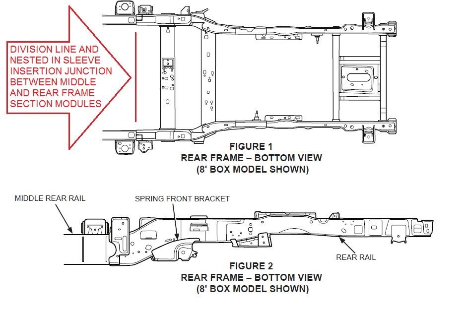

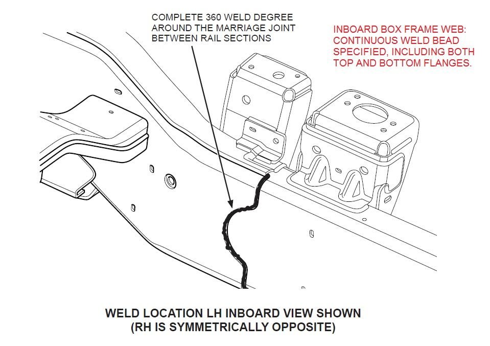

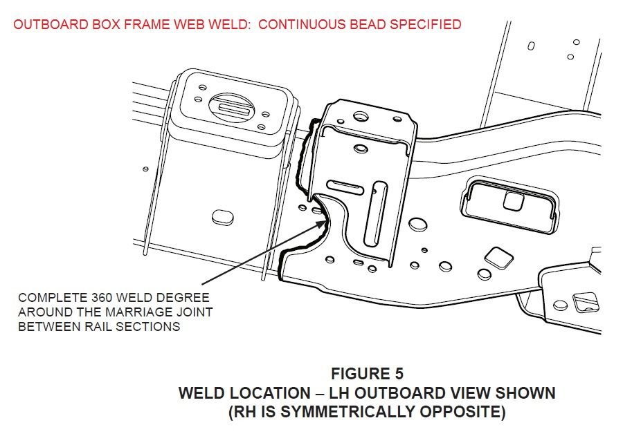

Perhaps not as egregious as it may sound, as Ford actually has an app for that...

Keokie... I don't disagree with the fact that a body shop rarely, if ever, rebuilds a car as good as the programmed robots and the well practiced factory workers who produce a Ford truck every 60 seconds.
The repaired truck will most likely not be as good as it was before, due to being held at the mercy of whoever is rebuilding it. How many have they built? How good are their welding skills? How conscientious and careful are they... or how rushed are they by the body shop's schedule and profit motive? How many 17 up Super Duties have the body shop employees rebuilt from frame section up? How fastidious were they in their cross measurements for squareness on a rear frame that tapers? How dutiful were they in the application of corrosion preventative procedures? How much do they give a darn... and are they paid to give a darn, or paid to get it done quickly?
I get it.
I just wanted the OP and others to see what Insurance companies know when it comes to frame repairs on the 17 up Ford Super Duty. Ford has procedures to section and replace portions of the frame, and Insurance will likely side with Ford over fear.
