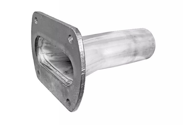

Hi
i would bypass the catalyst with a tube and need this part :
https://www.ebay.com/itm/FX2016-3-OD-Exhaust-Flange-Converter-Pipe-Reducer-Replacement-Repair-w-Gasket-/171368877912?mkcid=16&mkevt=1&_trksid=p2349624.m25 48.l6249&mkrid=711-127632-2357-0
But unfortunately, this one is out of stock with this EBay supplier. Somebody can
help me please to find this one in an other supplier online ? Not find on Rockauto.
thanks

Contact the seller to see if they will be re-stocking this part--also ask if they'd ship to your country and could they quote you on a price. If they will not be restocking ask if they know of other sellers or vendors or who was the original manufacturer.
If you're unable to find someone who'll ship to you I'd be willing to act as your "middle man" if that's helpful.

Yes, the seller on EBay answering. This part is available again in the next 2 weeks . Sound good for me.
The engine became hard, as if it were being braked. I had no more power to drive after 65mph. It runs fine as usual otherwise. As I removed the smog pump, I imagine that my catalyst is clogged (?). This is the original 30-year-old catalyst . It is for this reason that I would like to try to delete it.
Any others suggestions are welcome…
