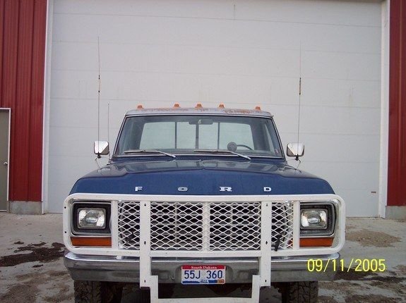

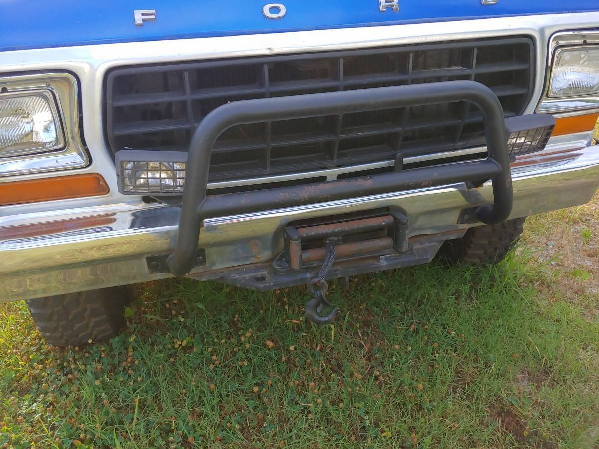

37.56 wide in the front. Is it a old style cattle guard like the 1st pic or a "Cactus Pusher" like in the 2nd pic? Also if it is designed to match the curvature of the front bumper front edge on a 73-76 it is more rounded overall and is different than a late 77-79 that has the flat front edge.
