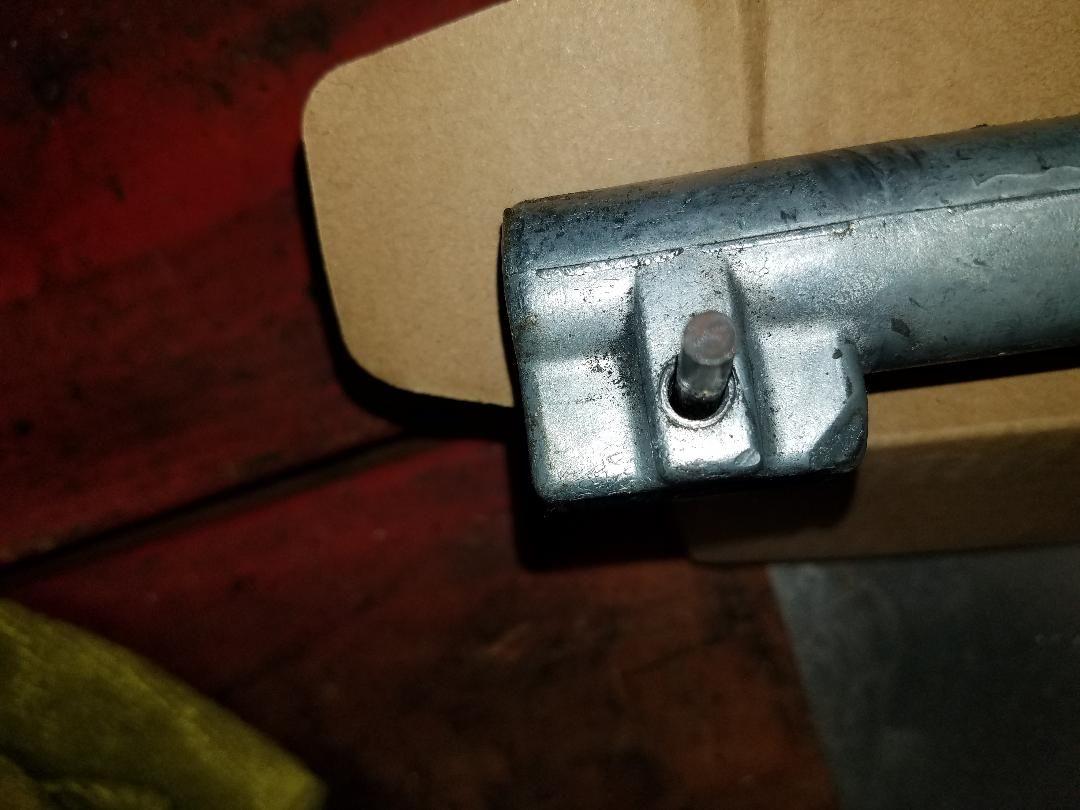

Folks, this has been driving me nuts for a bit.
My column shifter is.. .extremely vague. I replaced the plastic bushings, tightened the screws per Makuloko's YT channel (and while the old bushings were a bit worn, the screws were fine).
Is there anything else to replace? The bushings helped but selecting the proper gear is still an exercise in patience.

Replace the entire shift tube assembly. Here are part numbers (from tasca a year ago, the dorman assembly is also decent)

^^^this. Mine was still sloppy as well. The shift handle to tube mounting area - where the pin passes through - was oval shaped.
I ended up getting the Dorman 905-102.

Aha, I see - I think the spring 6L5Z-7379-A and the rear metal piece with the positions - 3C3Z-7A216-BA - would possibly also help in my case so I bought those as well.
Now to figure out if all this can come out of there and go back in from the top - I think so?
Edit: @BWST I just saw your post, I think that plus a worn spring + back 'position' bracket (which is the piece that has the detents and could very easily be rounded off) are also a part of my problem as well as the egged out pin hole - the spring is certainly less strong than it should be. I will order, install and report back while my truck is lacking half the front suspension anyways.

It can be done from top, with plastic covers off, and helps to pull cluster, or you can remove covers and drop the steering column down some to allow more room to access
