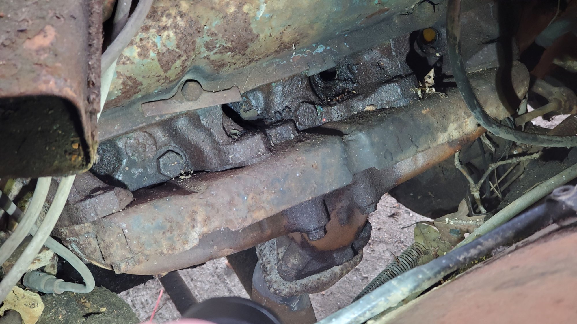

2 bbl carb, previous owner says it's a 390 but I want confirmation before we pull this stuck engine. With air brakes and the block requirements for the compressor I doubt this engine has been changed out. Thanks in advance for help.

FE or FT. I can't see the exhaust manifolds. If there are 2 bolts per port plus 2 in the middle, that's an FT. I will try to decode it later today. Waiting to have my hoof fixed

The manifold has the two extra bolts in the middle, so FT.

361 The high fan is odd but looks to drive air compresser, The serial number is stamped on top of rh frame rail in area above the axle.

F80 = '64 to '69 F800 gas
K = 361 2V FT gas V8
U = Louisville Assembly Plant
491446 = 1964 numerical series.
FT engines share the same basic design as FE engines. But, the heads and manifolds are different, the crank in the 361 will be a steel crank with a larger diameter crank snout. Mounting is via a cast front cover and perch and ears on the bell housings. Side mount holes are there, but not used as they would be in cars and pickups.
Blocks differ in provisions for air compressor oil return, the distributor passage and possibly in a little beefier construction in the lower end.
