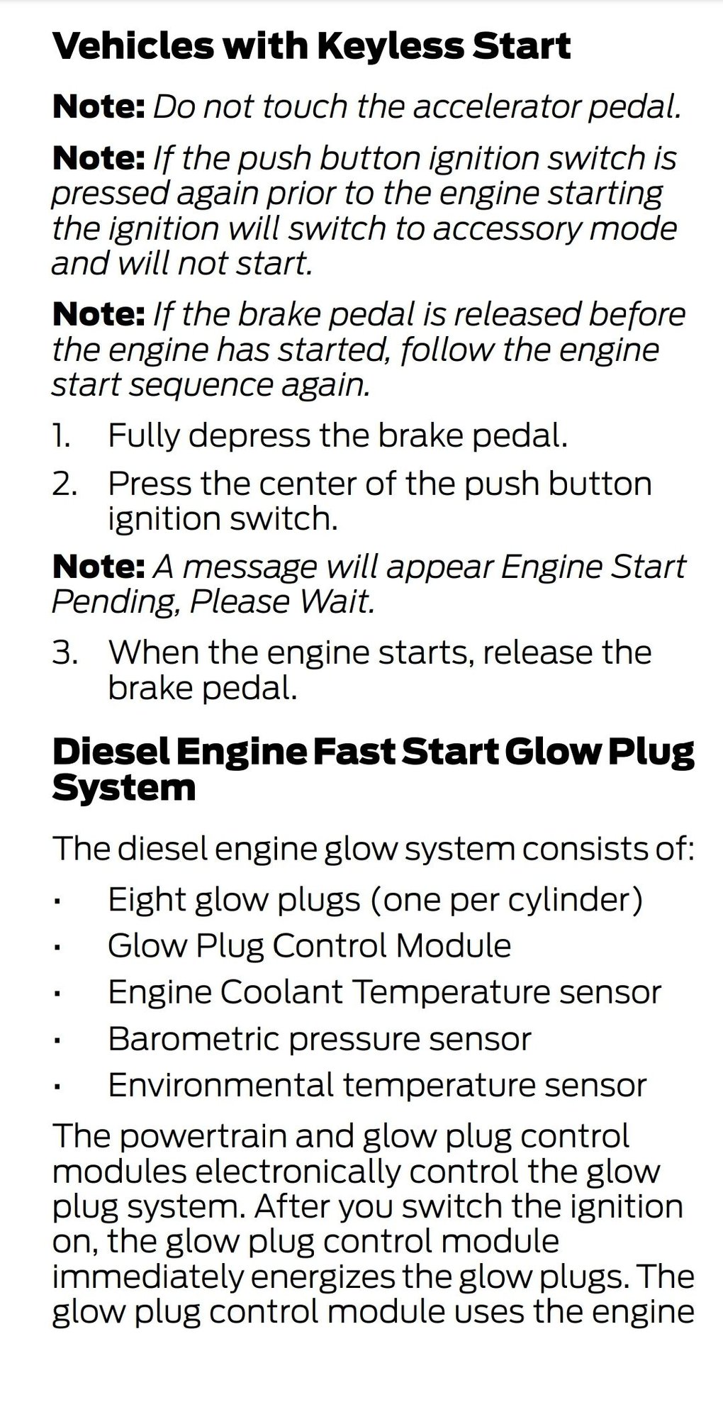

Most would be correct based on how the manual describes starting it. If need be, such as in very cold weather, there may be a message and delay in starting. Bellow is a partial screen shot for the push button diesel starting procedure.
