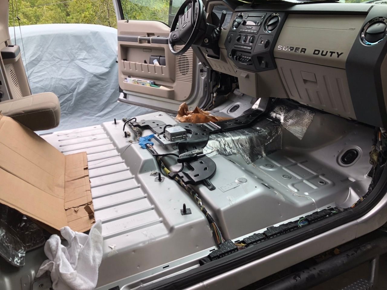

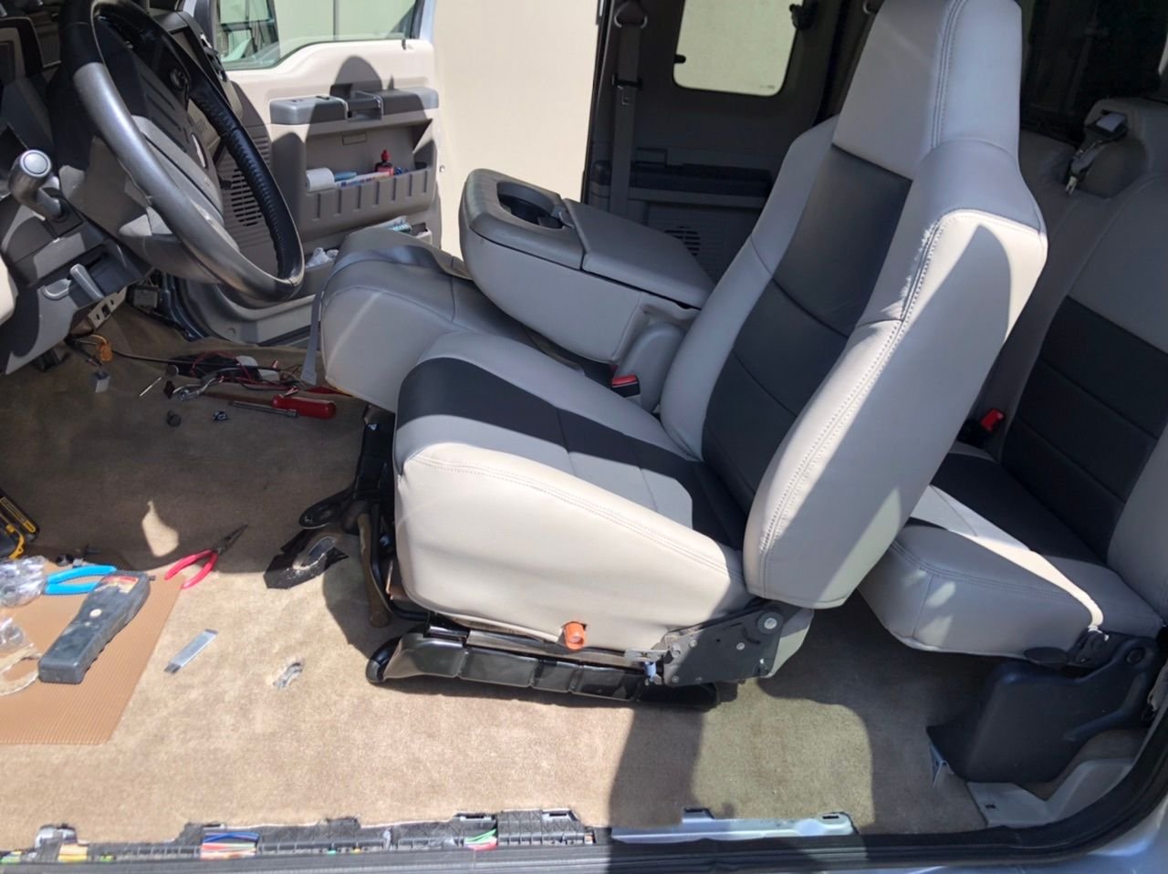

As FarmerFromKansas stated, Not that hard of a job to do - just time consuming to get it right. My 06 XLT had a cloth interior & the drivers seat was badly worn. I decided to get a Katzkin full leather replacement kit off eBay. If I remember correctly the entire kit was about $780. I bought a Ford drivers seat cushion that was about $125 at the time. From what I've read the cushions supplied by the Seat Shop are just as good for about 1/3 of the price. I bought a GOOD pair of Hog Ring Pliers - about $26 off eBay and package of 3/4" Stainless Hog Rings and went to town. The upholstery work itself took about 2 days but I spent a good week doing the job because while I had the seats out I removed the carpet and shampooed it, removed ALL the seatbelts and cleaned them, cleaned & repainted the seat tracks & brackets as needed etc. I also installed the seat covers outside in the summer when it was 105 Degrees out. While I was sweating like a pig the outside temps made it easy to stretch & work the wrinkles out of the upholstery. The next day I left the truck out in the heat with the windows up and about 3PM I went out and worked the last little wrinkles out. It came out perfect. You can also work the wrinkles out using your wife's hair drier but I felt it would be faster & easier to do it out in the scorching heat - just my opinion. I did this by myself and had no way of getting the back seat out so I disassembled it in the truck one section at a time. I've NEVER done any upholstery prior to this. I just watched the Seat Shop upholstery videos and went to work. I think I was about 64 at the time, so I was no spring chicken. After doing my truck, I've since done the drivers seat & cushion on a friends F-150 & the drivers cushion on my sons Dodge truck. The Dodge was the easiest. All Velcro - no Hog Rings.
My install followed this almost exactly. Very pleased and I never considered myself skilled at interior work. New carpet and sound insulation too.

David h, Beautiful job! I like the 2 tone seats. I kept with the single tone grey with perforated center section.
