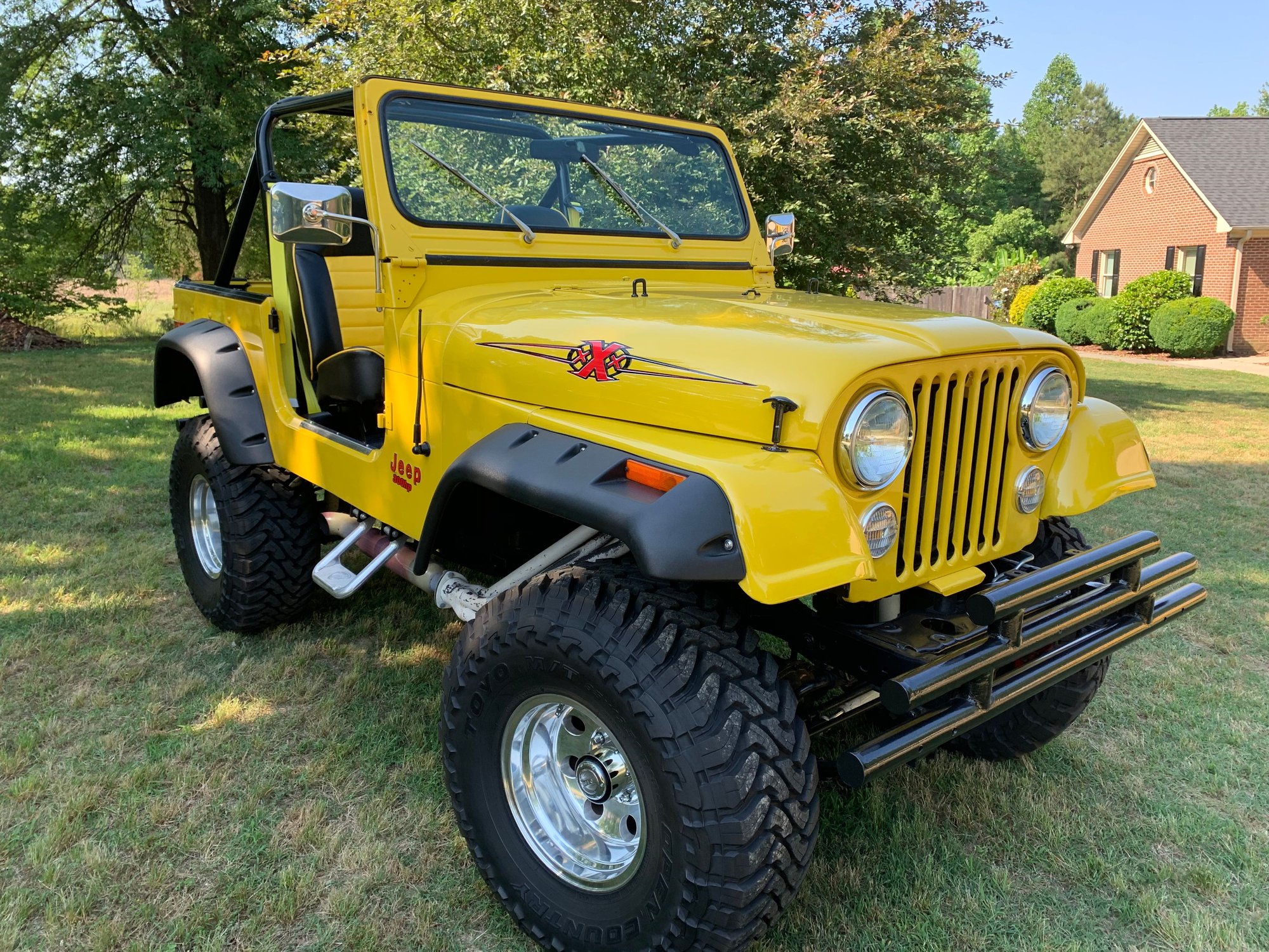

I built this Jeep 5 years ago... Ground up
