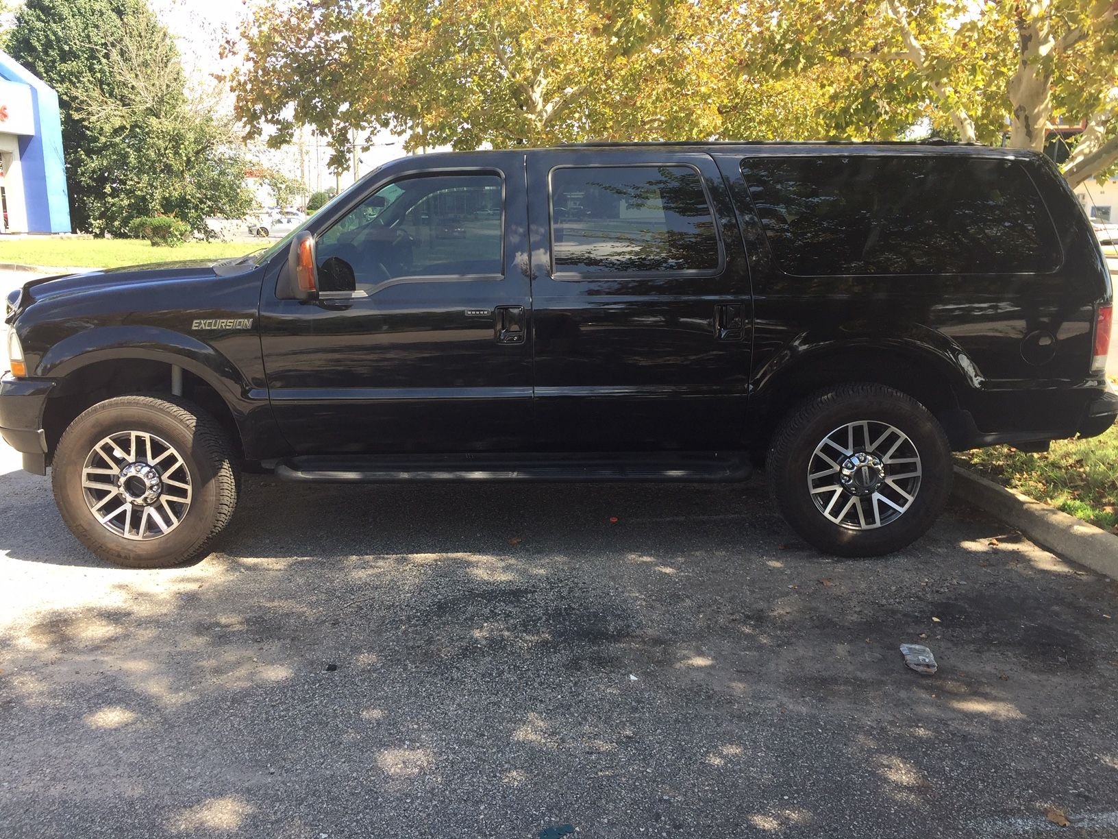

I thought $26,000 was a lot to pay for a 2001 Excursion XLT 4WD, 7.3 diesel, 79,000 miles. No rust. Spent whole life in San Diego area. Here is a picture of mine with its new 2019 F350 Tires / Rims. $75,000 is insane.

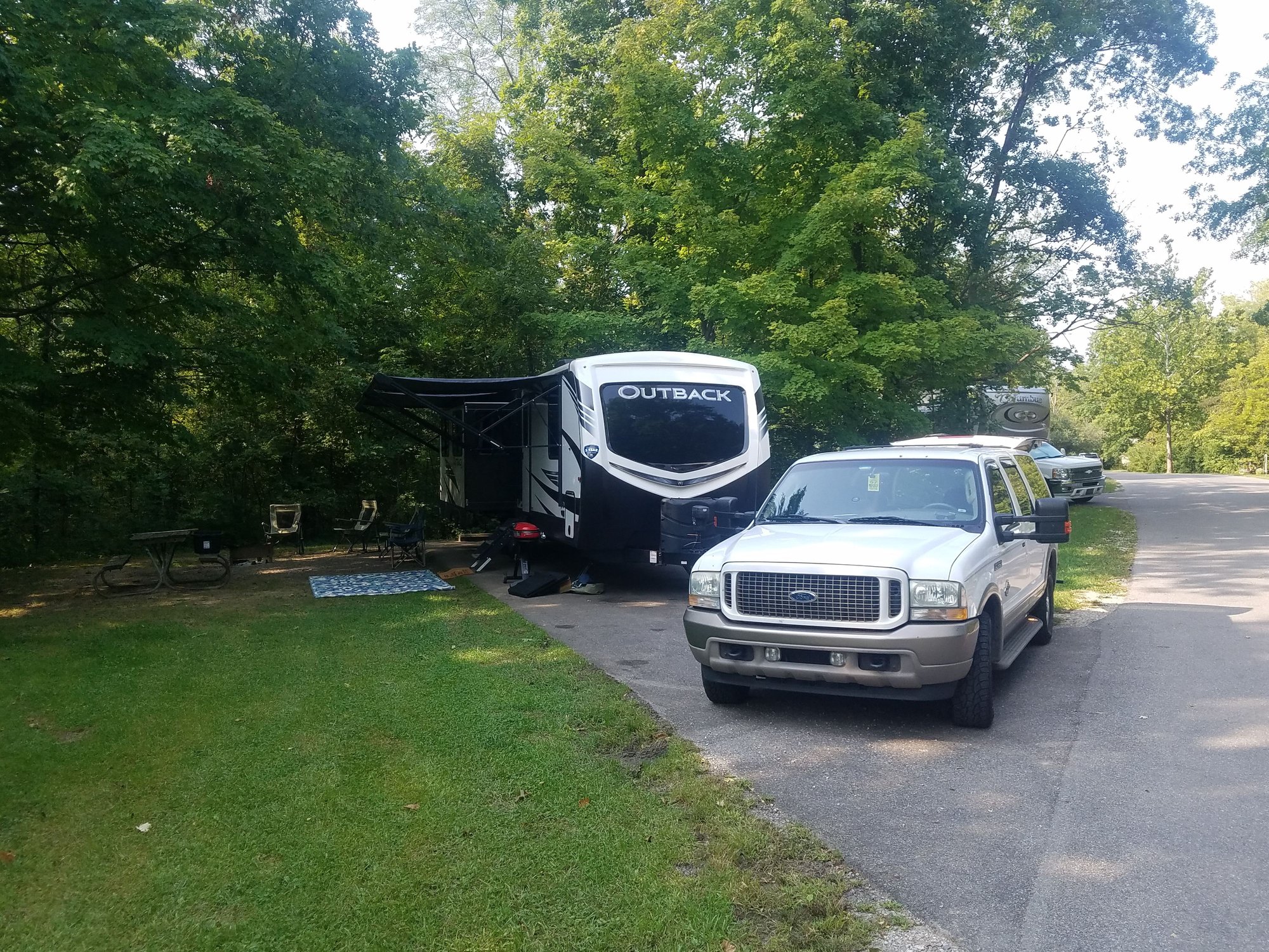

Good thing I bought my 2003 6.0 Excursion 2wd in 2018 for $4600 then! It came from Tennessee and has no rust! Sure it isnt perfect, but tows like a dream and gets better fuel mileage than anything else we have. I just got 19.6 coming to Carlile Pennsylvania from Columbus Ohio for the World of Outlaws Sprint Car race. I dont have my camper with me, but it's the most recent pic I have of the beast!

what did you have to do to mount those? Did you need spacers? I understand the newer wheels have a way different backspacing.. I am thinking of putting the wheels and tires off my 2017 F250 on the '05 eX..
EDIT: I found the answer in another thread..

I had to add 2" spaces as discussed on this board. I also bought the good ones for $200 each. Figured if I was going to take a risk and run spacers I was getting good ones. Ordered mine from wheeladaptor.com.

What parts
Vanavymam
Is it spacers and new lugs to get through them?
so each wheel hub us to get new lugs and then the spacers?
any other parts?

I bought the 2" spacer set. It came with all new lug nuts from Wheeladaptor.com. I did end up having to cut some of the wheel well out to not rub. It's been mentioned on here a couple times that some did not have too but for mine to not rub I had to cut out about 6' across the bottom.

I really like those wheels! You just need the newer mirrors!

Stock susp?
I know you told me they are 20”…so 33” tires …but is that on stock suspension? With no rub other than minor plastic trimming from wheel well?

Correct. Stock suspension.
