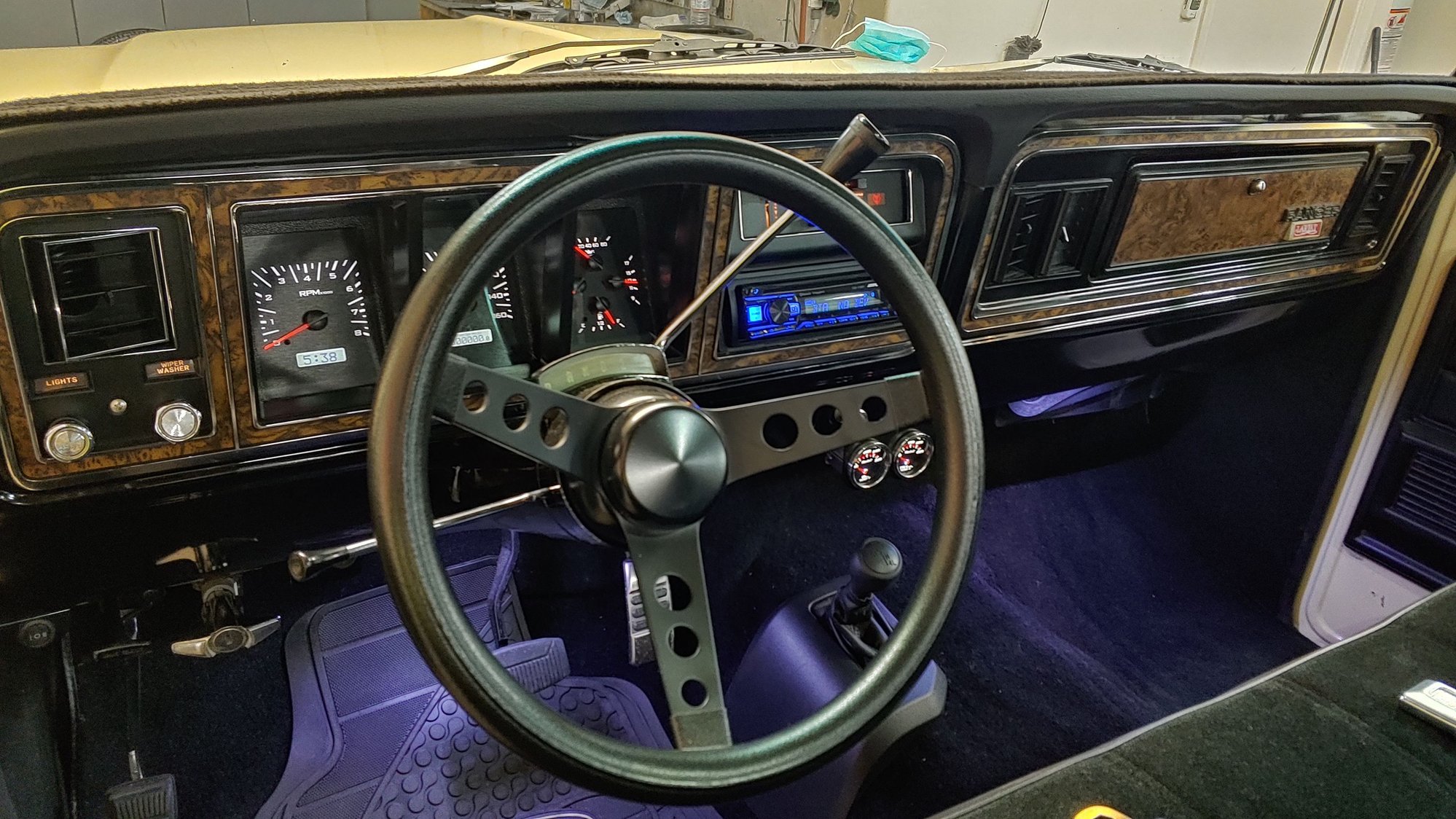

We went with a Grant steering wheel on an Ididit column, and a set of Speedhut gauges set in real walnut burl veneer. (The veneer is all cracked and kind of sketchy looking, but it has actually aged a lot better than the replacement repop dash insert!) I really like how our truck looks like complete crap on the outside, but it has a recent inspection sticker, and everything works, except the fast idle cam business at startup, and the wipers don't park most of the time. Everything else works. Windshield washer, horn, no stupid jerry rigged crapola. She's a respectable truck, even if she is old, fat, toothless, and has ***** hanging to her ankles.
Dash with custom gauges, steering column, and wheel
