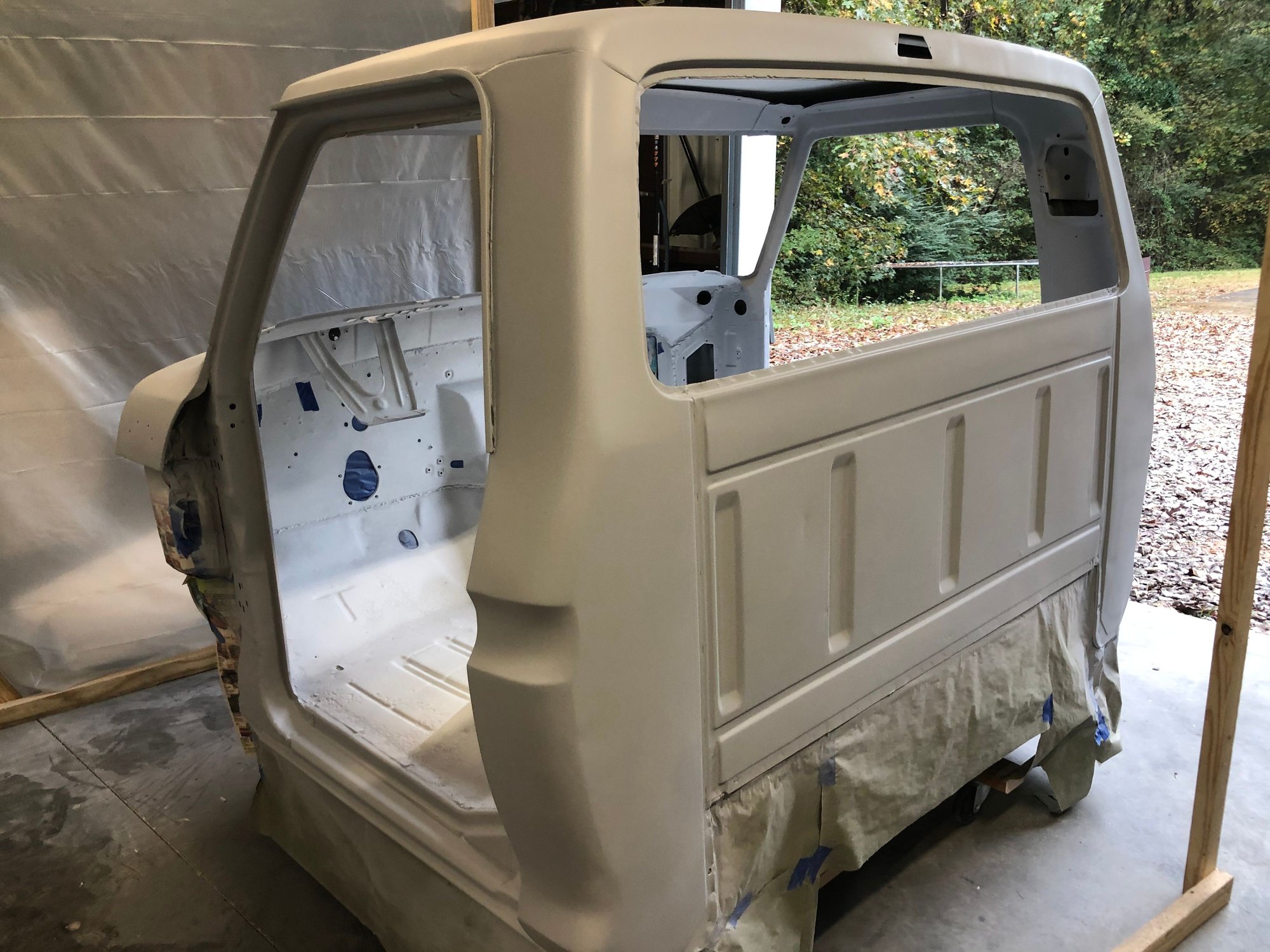

The large hole facing forward on right side of cowl through a large rubber plug. Someone will probably have a diagram from shop manual.

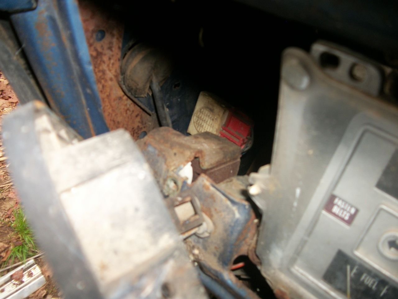

This is the dvrs side, see the rubber boot with the black cable coming thru it in the cab wall? The plug is about 1/4 or 1/2" thick and has a cut thru 1/2 of it.
See the blue box? Now with the glove box liner in place and if you truck has a/c, the passenger side a/c ducting is going to make it harder to get to.
