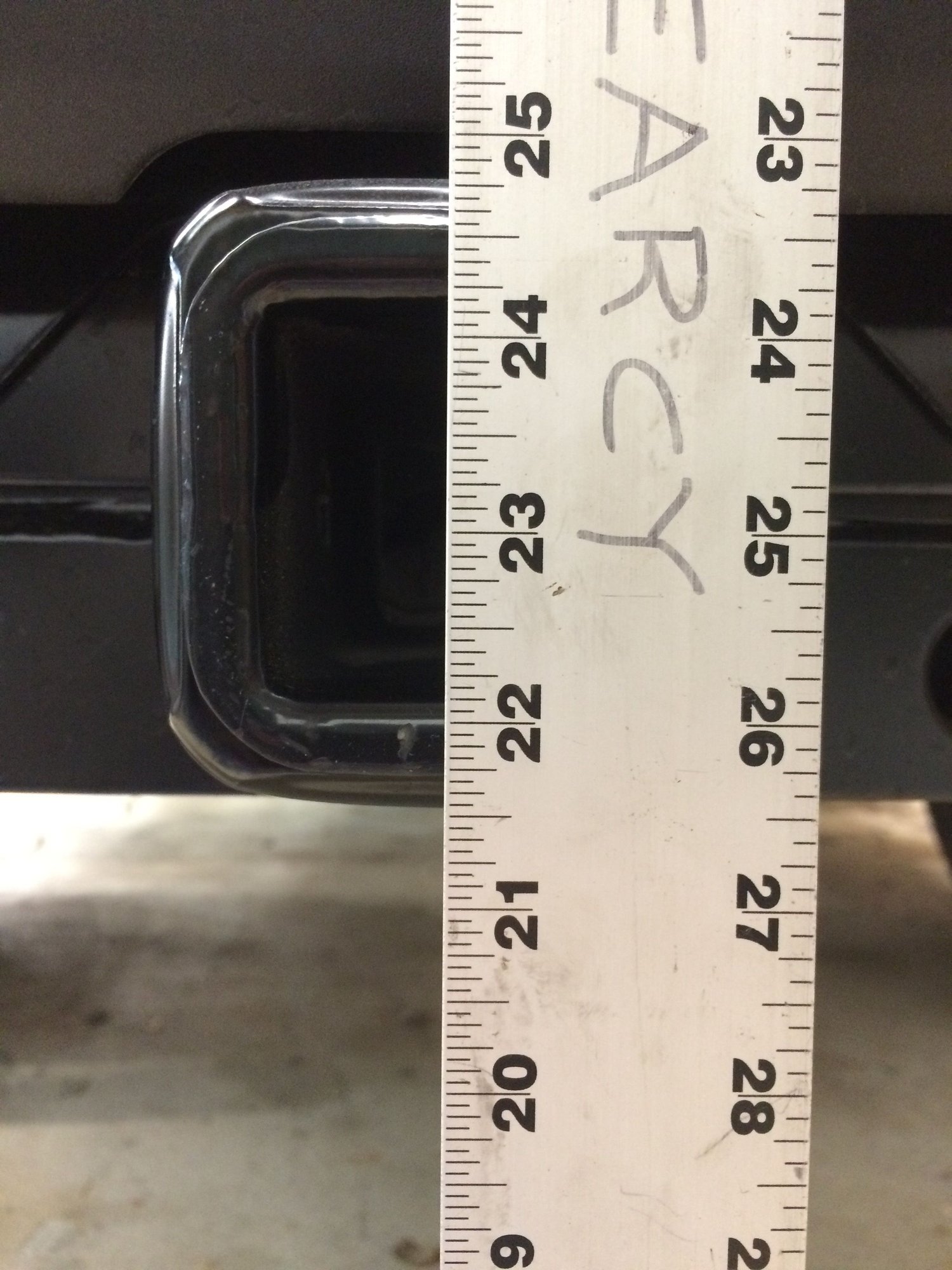

one post shows 22"
another post shows 24 3/8"
Ill probably go with B&W Tow&Stow 7" drop....but not keep it in the receiver (stow under rear seat). Dont want something hanging that far down on my truck.
