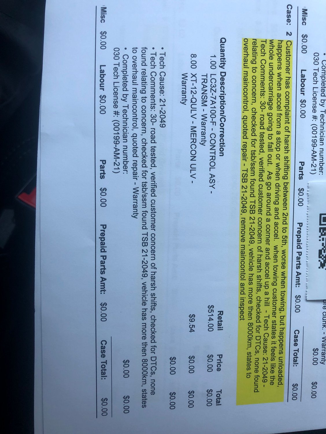

I had issues with mine; getting warranty work done and there was a TSB. Details attached. 2020 10 speed
