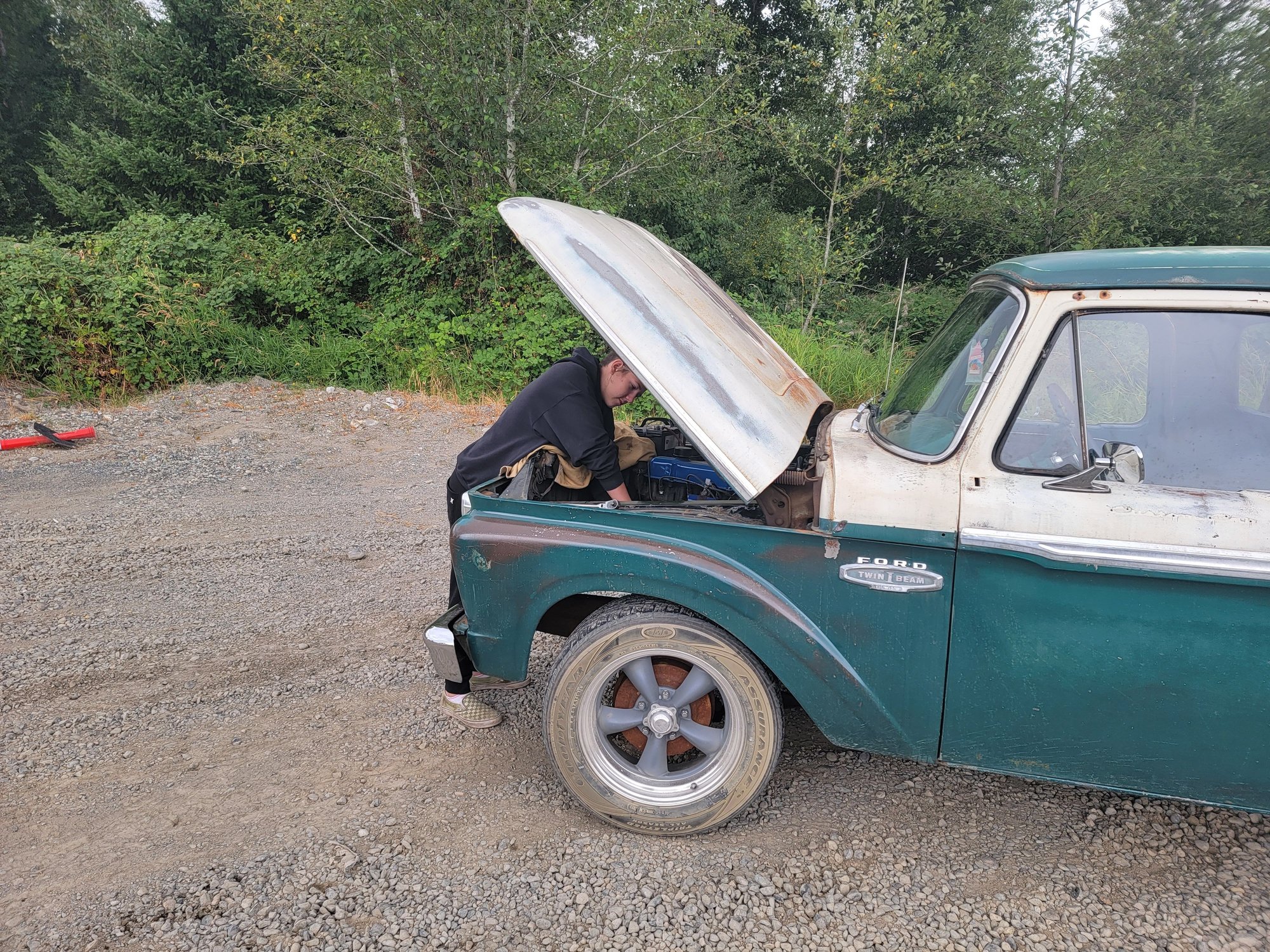

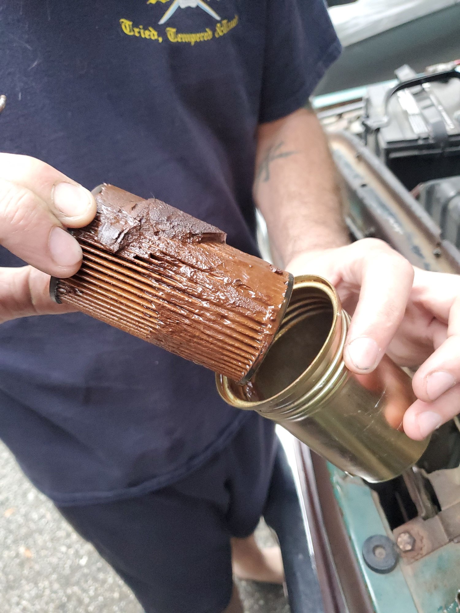

Kids and I decided to go camping. We also decided to to take the 66.
I've owned this truck since February. Mechanically it's sound. We loaded up some basic tools, fluids and headed out.
I didn't take into account the fact our favorite camp site is down a 22 mile long dirt road that in bad shape. So all the issues we had were, from what I can tell, the vibrations. We had a no start at a gas station that was a loose battery cable. We lost the air filter. The 22 mile dirt road was traversed 4 times in total. So, we abused the ole girl.
On the drive home we started having fueling issues. Now, when I bought the truck it had been driven a while. It clearly had a new fuel pump. I wrongly assumed the fuel system was cleaned.
I didn't have a means to change the on pump filter on the drive. There is an inline that I cleaned twice. I also pulled the carb and cleaned it along the road side. After a while she seemed to be fine. But I grabbed a wix in the way home and changed it right away. The pictures tell the story. I'm going to have to drain the tank and clean it

Wow, some nasty in there!

I expected dirty. But nothing like that.
