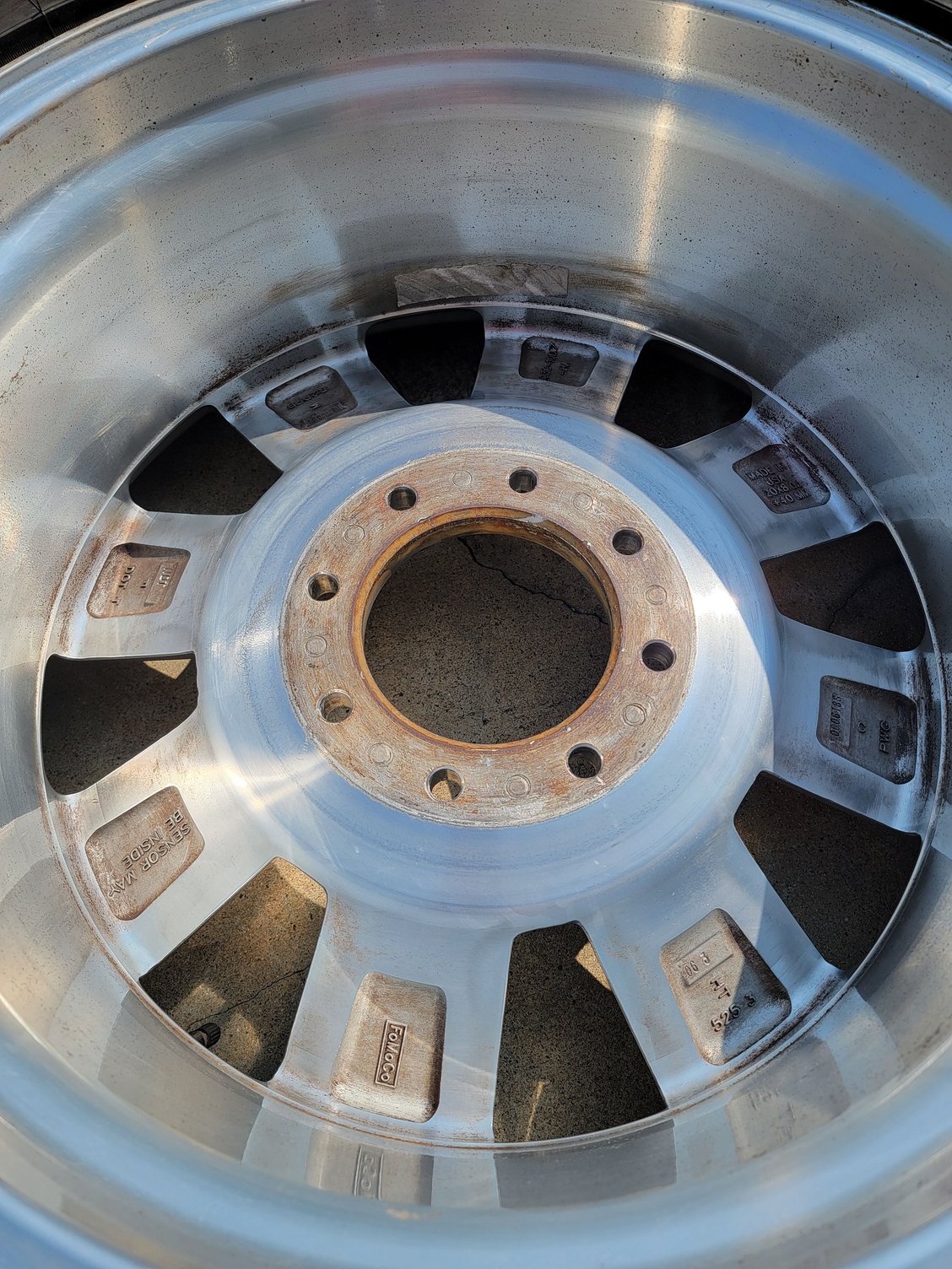

I spoke to the manufacturer today and was asked to provide a picture of the back side of one front and one rear wheel. I removed the rear drivers wheel and this is what I saw:
The truck's studs were obviously poking out just a hair beyond the front face of the spacers. They will say this is the cause of my problem and they may be right. One of the reasons I went with 2"studs was because everything I read said the studs wouldn't need to be trimmed. Their instructions clearly state that the studs must not make contact with the back side of the wheel.
Yup, that's a big no no, big problem and could have caused your issue.

This is a very common situation where the vehicle studs were too long and hit the back of the wheel, causing the adapter/spacer studs to break. I've seen a lot of these pictures over the years. This is really the installers part for not verifying the stock studs don't protrude from the adapter/spacer, as most who are experienced installing these know better.
