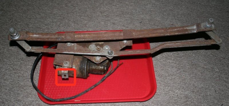

I took the motor, bracket, spindles and arms all out together
Old Aug 15, 2021 | 04:35 PM
EffieTrucker's Avatar
EffieTrucker
Phantom of the Phorum
Joined: Jan 2011
Posts: 5,472
Likes: 1,696
From: Kentucky
Edit to add: What Marten said.

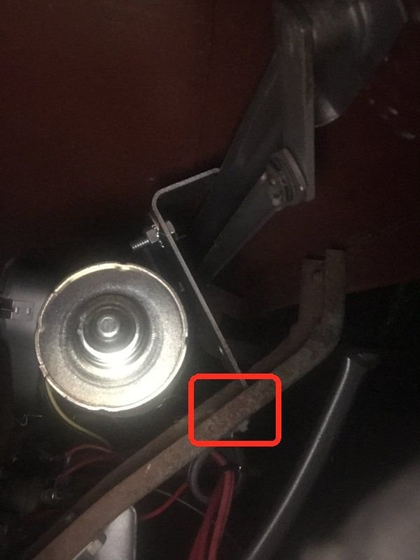

If you remove the whole assembly there is only one bolt under the dash.
You will need to remove the big nuts, trim washers, and seals under the wiper arms themselves, then the one bolt under the dash. Then you have to fish it out around the bracket holding the cowl vent handle.
There is one bolt here holding the assembly to the cowl vent handle bracket.
Bolt location under dash, from passenger side.

Nuts! Thats the bolt im having trouble with! Thanks for the info!

The bolt is turning and i cant fit in there to get two hands on it.
