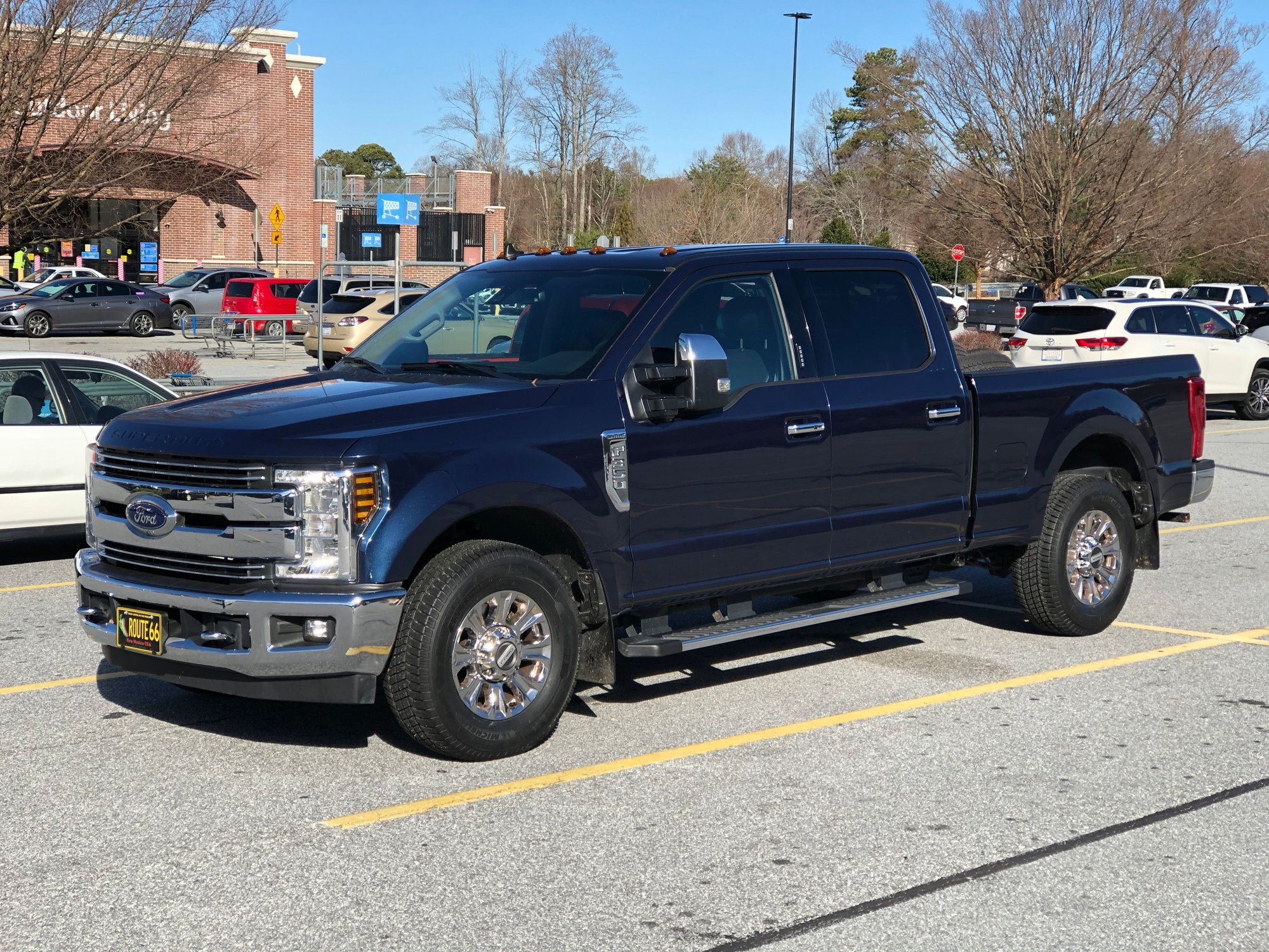

We ordered our 2019 F-350 2WD 6.2 with the optional 4.30 axle. I changed the OEM LT275/65R18E tires to size LT275/70R18E (see pic below), and I had our dealer reprogram our truck for the new tire size to correct the speedometer, odometer, trip odometers, and mpg displays. The effective axle ratio changed to ~4.16.
The main purpose of the change was to unofficially increase our truck’s GVWR and payload, but I must admit that I like the improved appearance.
